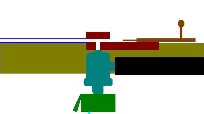

It's nothing special, but I'm kind of proud of it as it's the first one I've made. It's a single shot QEV style launcher with a scope mounted and a custom stock. It's filled through a schrader valve I've epoxied into the side and designed to fire 6mm ball bearings through an arrow shaft sleeved in a piece of 1/2" copper that JSR kindly recommended I use all that time ago.
I've become a bit more confident with my soldering abilities so I think I'd be able to take this one up to 400psi without any issues, however so far I've only taken it up to 250psi to fire some wadded screws out of as a test.
The stock was kind of a rush job and I'm not completely happy with it as I messed up the butt a bit and made a few rough cuts, but I think looks okay and does it's job.
The scope is a 4-16x illuminated adjustable objective, which is kind of overkill for an airgun but I had it lying around so why not. :D
Anyway, here are some pictures, unfortunately I am still waiting on my ball bearings to arrive, so I haven't even sighted it in yet. As soon as they get here I'll upload a damage video to Youtube. :)

the barrel bore maybe too small, it will detract the air flow from that qev, you should make a bigger bore(+6 mm) or use a smaller qev :)

The one thing I don't like is the moving barrel. In order for reasonable consistency to be achieved (on spudgun levels at least), the barrel and sight should be fixed as a permanent unit irrespective of any other moving part. Any play in the system will translate into sloppy accuracy at anything above point blank range.
Personally I'm an advocate of cutting a hole in the barrel then sleeving it, and mounting the bolt on the sleeve.
Have you made any provision to retain the projectile, such as an o-ring or magnet?

Yeah I completely agree, I was going to sleeve it in some 3/8" copper and drill a hole through the 1/2", not sure why I didn't end up doing that, I guess I was worried about losing a bit of air through it when it fired. There's still time I guess. :D
jackssmirkingrevenge wrote:Have you made any provision to retain the projectile, such as an o-ring or magnet?
Not yet, I was planning on throwing a magnetised washer on the back of the barrel or putting a tiny mark just inside it to hold it still so the shot won't roll away.
To be honest I'm kind of hoping that the bearings I ordered will be a tight enough fit that they will hug the barrel close enough and I won't have to worry about it, it's wishful thinking though.
r00kie wrote:Yeah I completely agree, I was going to sleeve it in some 3/8" copper and drill a hole through the 1/2", not sure why I didn't end up doing that, I guess I was worried about losing a bit of air through it when it fired. There's still time I guess. :D
Even without o-rings, a tight fitting sleeve will have minimal air loss and the benefits in accuracy should be worth it.
A few shallow holes drilled in the breech face in the barrel and filled with cheap powerful neodymium magnets should do the trick.
Mindless optimism I fear, such a tight fit means there will be far too much friction and significant performance loss. Remember, what you want is maximum friction at the breech (because the longer it takes the projectile to start to move, the more time the valve has to fully open) and minimum friction along the rest of the barrel, so none of the accelerating forces will be wasted overcoming friction.

Nice
instead of cutting holes in the barrel you can use a T and load ammo from the rear port then push it into the barrel with a bolt
Only problem there is I'd have to reposition the QEV, ergo the stock wouldn't fit properly. I'll keep that in mind for my next one though if I use a QEV as it's a good idea, thanks. :P
