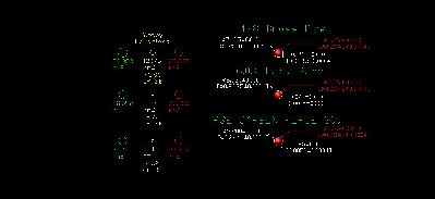

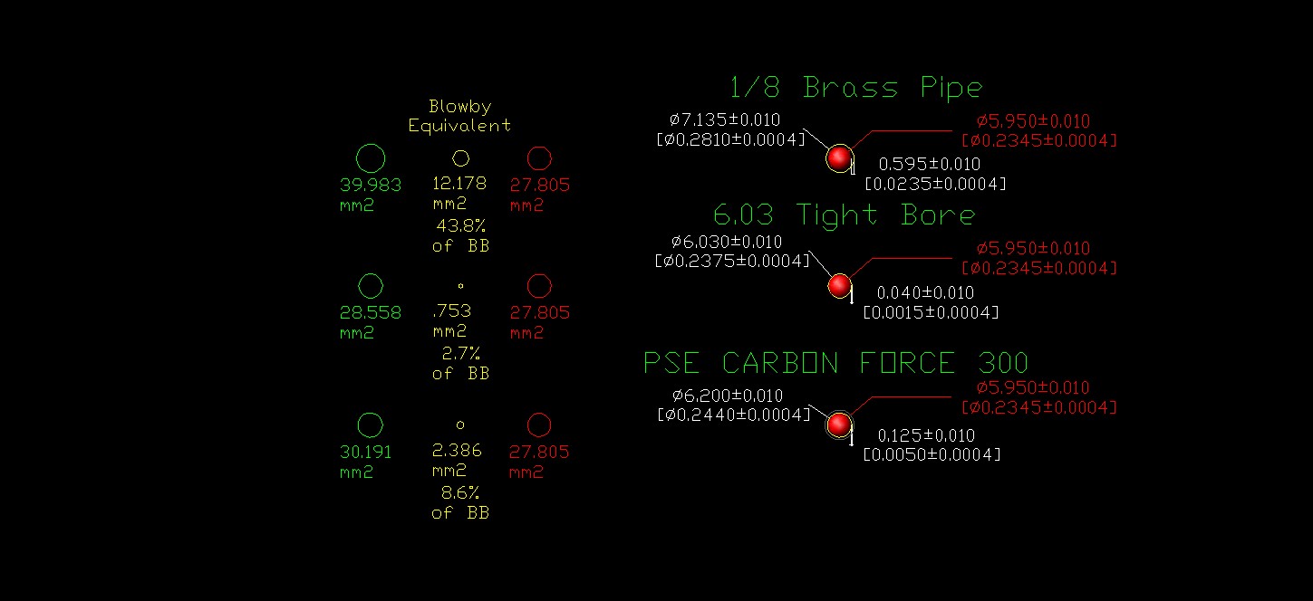

Here is is a comparison of blowby percentage based on the BB diameter. Basically it shows loss of power between barrel types.
Your 1/8 inch pipe requires about 40% more power than a tightbore barrel.
Your pipe barrel would require 140 psi verses 100 psi for a tight bore for equivalent power.
This should explain why you need a tight bore barrel.
