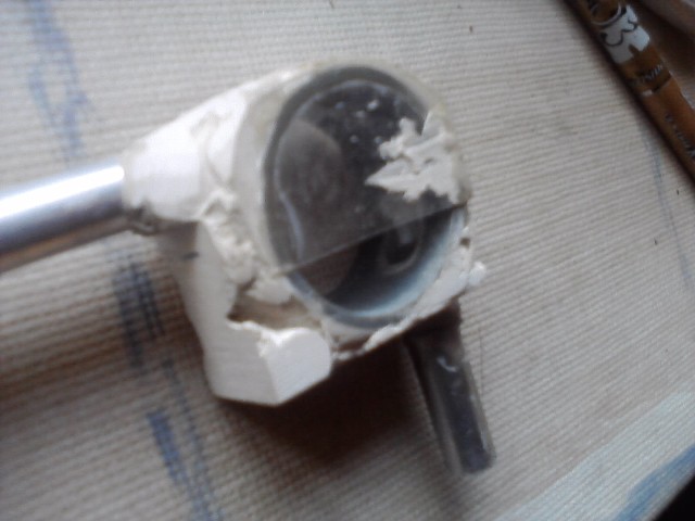

For this one I used plastic, and wood, and epoxy ;)
