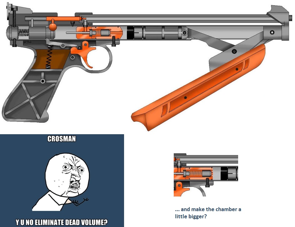

You can have a conical bolt face with a stem:

ive thought about this idea... but on larger scale wont the air flow be terrible and if the hole is too big the ammo will fall through?
Um...if your projectile is 0.500", make the hole 0.499" - the projectile won't fall though and there will be no appreciable difference in airflow.
You could also have say a 0.75" hole and just put a single thin wire rod across it...

talk about precision, i guess that makes sense now thank you JSR for clearing it up.jackssmirkingrevenge wrote:Um...if your projectile is 0.500", make the hole 0.499"
