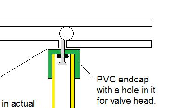

Can you guys please check if this design is sound in theory?
It's based on Antonio's design located here:
http://www.spudfiles.com/forums/viewtop ... tml#152862
I'm going for a bolt action gun, so it's not going to be automatic and there's no parts that need to be moved by air pressure.
Thanks in advance.
Looks good on paper, but some gripes:
- you're going to need fairly high pressure to make that "small burst of air" give a significant impulse to the projectile, I expressed a similar doubt in Ant's original thread. Still if it's for airsoft purposes and you don't need that much velocity it should not be an issue.
- pushing on the valve head with a plastic BB sounds like it will be putting significant strain on the projectile, make sure the tip of the head is well rounded.

Thanks jack.
Would around 100 PSI be enough?
I can always increase the length of the stem sticking up into the barrel to increase the amount of air even though more air would be used per shot.
Also, how would you recommend rounding the head?
Would a file be good enough?
Binary Blue wrote:Would around 100 PSI be enough?
For skirmishing, probably.
You can start with a long stem and shorten it to "tune" it. More power needs more air, there's no two ways about it ;)
I suggest clamping a power drill in a bench vice and using it as an improvised lathe, you'll get faster and more consistent results.
How do you intend to put it together in terms of materials? I see a lot of epoxy being involved...

The air reservoir won't be attached to the barrel like my picture shows. I'm thinking of something more like this:
A note about the stem seal, if you make it like you drew it what will likely happen is the attached, the stem will move down but air pressure will keep the o-ring sealed against the port and no air will come out.
Binary Blue
Posts: 40
Joined: Thu Sep 01, 2011 6:37 pm
Yeah, there should be a hole around the grey stem in the green PVC end cap part. I just forgot to draw it in.
Fixed:
Better :)
How big is your air reservoir, and how many shots do you expect from it? 100 psi is not much for a repeater, albeit a small one.
