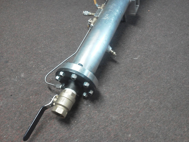

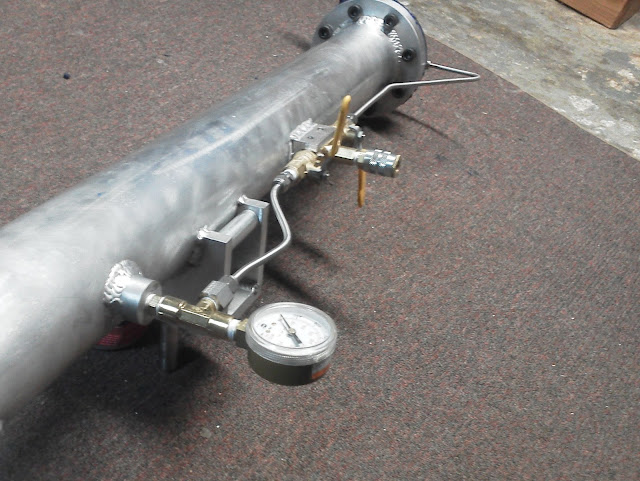

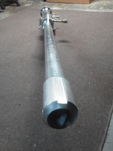

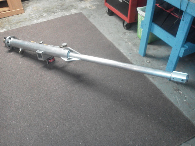

I started building this cannon as a way to launch heavy baits while surf fishing for shark but it quickly got out of hand. As for the specs - Its all aluminum, 2" ID barrel, 4" OD chamber, The piston is made from teflon, 1.5" rear ball valve, So far its only been fired with compressed air at 120psi but I built it to run on helium at 200psi. Everything except the fittings and valves were machined, welded, and built by me (yes I work as a welder).
I had a few problems initially, first I kept blowing out the rubber seal on the front of the piston. I had tried to glue it but ended up tapping the teflon and using a bolt/washer to keep it from flying off. Next I realized its too heavy to hold and fire so I had to make a mount to put it on a tripod.
After that it was mostly minor problems, leaky fittings etc but now it works like a champ. I was able to put a few spuds through some pieces of plywood and launched some at a friends farm. I'm excited to try it out on helium this weekend to see what it can really do.
Anyway here it is! I'd love to here some feedback if anyone sees areas where I could improve my design. And yes I am already planning to build another one!
