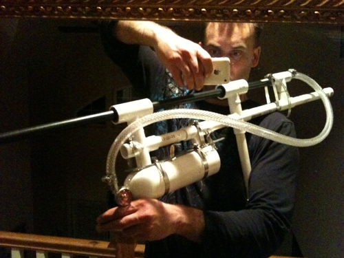

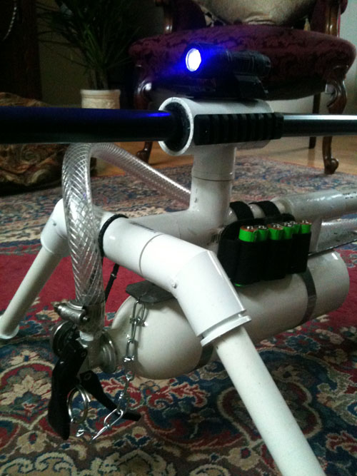

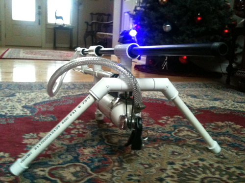

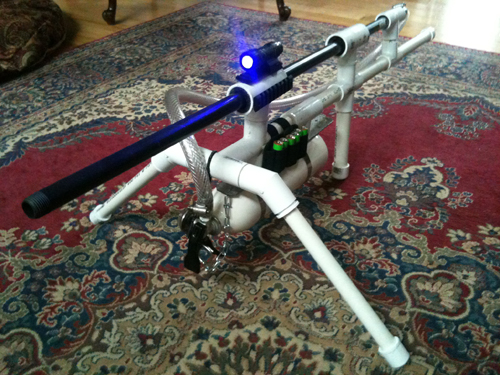

Hey guys,
Newbie here. Just built my first simple air cannon. I call it the "Scorpion", based on the PVC bipod and other scorpio-aesthetics. You hold it like an RPG to fire.
It's muzzle loaded, for now (something I would like to change), and the WHITE PVC is just structural, none of it is glued in (waiting until I finish the design). So no air travels down white PVC at all. The pneumatic power comes from the 100psi fire extinguisher connected via 1/4 vinyl hose (rated at 250psi) connected to a 1/2 PVC irrigation pipe (Sch80) I believe. I had to bore out the fire extinguisher's "barrel" to a 1/4 inch in diameter in order to get more air out of it.
I then used a quarter inch brass barb and 1/4-1/2 brass coupling to go from the hose to the 1/2 inch Sch80 pipe barrel. That, so far, is the only PVC on this whole contraption that funnels air.
In other words, anything connected has a 250 psi rating or above. The fire extinguisher itself is rated to 200, but I haven't charged it that high to be safe.
I thought the fire extinguisher (modded to have a shrader valve) would be a nice way to fire the gun, using its handles as a built in trigger. But I don't like the fact that, with one squeeze, all the air is dumped.
QUESTIONS:
What kind of simple piston design would increase velocity and add more power?
Would this piston design allow me to retain some air pressure in the fire extinguisher for subsequent shots? (in other words, multi-shot capability)
How could I breech load this or perhaps create a magazine fed/semi-auto capability?
I was also thinking it might be cool to shoot 1/4 steel ball bearings (slingshot ammo) out of this, in case of a zombie apocalypse. Perhaps a BBMG?, but I would want it to shoot a higher caliber round than just the standard .177. However, the AA batteries are pretty cool. With some duct tape, they seal the barrel quite well, allowing them to be shot out at a decent velocity even with the simple setup I have now.
Any ideas on how to improve this with the above design goals above would be MUCH APPRECIATED! At the end of the day, anything simple that could add power and create a multi-shot capability would be great. Creating a multi-ammo capability is probably a long shot, and I'm happy to stick with the AAs for now.
Thanks everyone.
-dolphman
:lol:
One more thing - the ultimate goal would be to make this thing as self-contained as possible, in other words; have some kind of portable air compressor/pump capability. Not sure how many pumps it would take to get the fire extinguisher up to 100psi. But the goal is to not have to have an air compressor be the only way to fill it.
before I added bipods (you can see how its fired, RPG-style)
