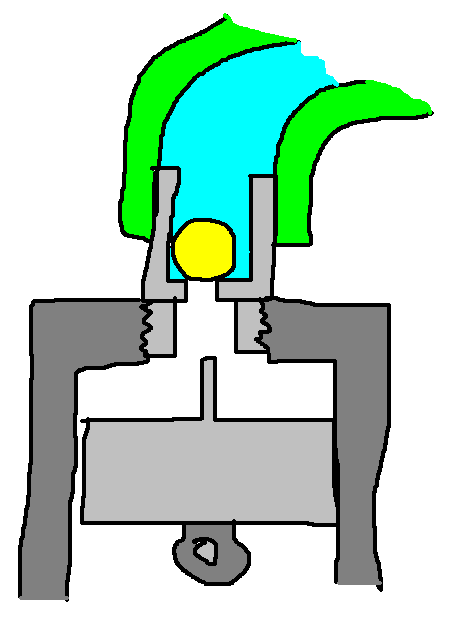

exactly, i was going to build one like that, simply a nail cut to the proper length and a decent sized check valve, but the check valve i needed was $25 and i couldn't justify spending that much on parts considering i have all the parts in the mail for one that will waste hardly anything. it will be better than that due to the fact it isn't made out of a broken leaf blower :roll: i wish the mail didn't take so long :(
Your check valve could simply be an airsoft BB in the hose barb that has been appropriately drilled out, twentyfive bucks shmentyfive bucks ;)
