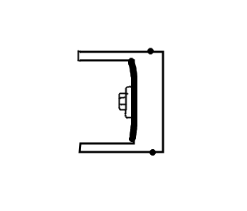

I'd recommend using a piston with the sealing face recessed back inside to save on weight. This is better to use on a barrel sealing design. You'll have to increase the travel a bit to ensure it doesn't block the barrel port with a chamber sealer.

- hollowpiston.gif (2.57 KiB) Viewed 23085 times

Edit: that is an interesting piston design but how would that work in a chamber sealing valve? i was planning on making a piston of the following design to save weight and it is near opposite of what you propose:

also, a 3'' dome end cap fits in 4'' schedule 40 PVC perfectly, and i have used one with some success.
Just bolt a big steel washer, and a rubber gasket into the inside of the dome, and you have a perfect piston for a 3'' porting cannon made in a 4'' T.
just be sure to use an really good bumper. i used coiled, and slotted rubber hose.
