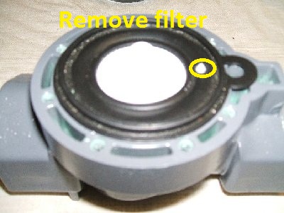

Purchase this one because this has been the easiest to modify and has been used for years. Plenty of how to's available.
Make sure to remove the white plastic filter from the diaphragm, make sure the manual bleed lever is closed and then epoxy the solenoid opening. Drill out the top to put a fitting for the blowgun.

- sprinkler-diaphragm.jpg (37.97 KiB) Viewed 6301 times

Look at deweys pic above, your valve should have the same little white thing in it, take it out, and it should work. Btw when I asked for pics I meant of your actual valve and your link didnt work for me!
