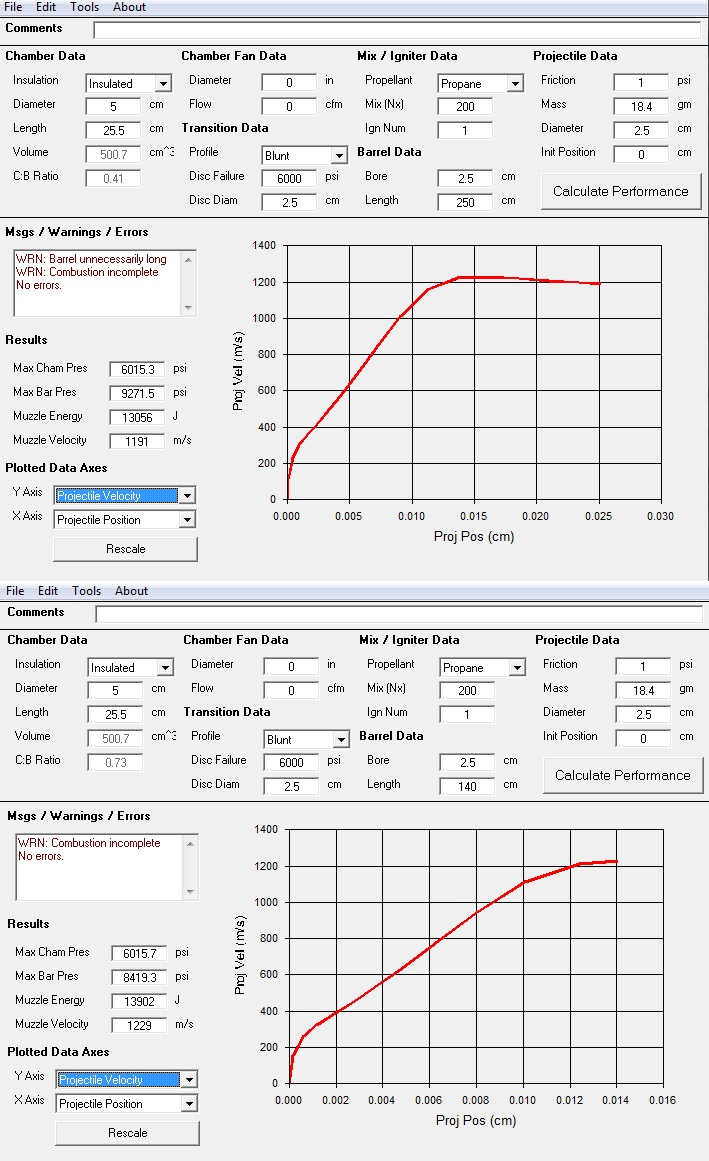

Here's some HGDT models using propane, for which 2.5 metres is too long a barrel length.
You might want to consider fuel/oxygen mixtures as opposed to fuel/air mixtures, allowing you to pack more energy in the system for a given pre-ignition pressure, though the dangers of DDT would then rear their ugly head and you would better hope that your chamber and barrel can take the strain.

Since your velocity is approaching the speed of sound in a combusted propane/air mix (in the simulation) the efficiency will be going way down. Since you are using helium as a buffer gas, your numbers will be higher than the simulated numbers.
You still won't get close to the velocities of 'meteorite guns', but it'll be a nice violent impact by hobbyist standards.
DYI will be able to give you some more detailed information.
You can use GasEQ to find an optimum mix, though I don't know if there is a translated version out there.

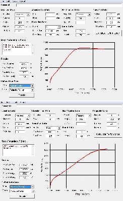

JSR:tanks for modeling in hgdt but i did it in ggdt because hgdt didnt have metane as fue,l and gave me 10053 f/s
with the sig specs
working fluid: helium
temperature:2000F°
pressure:25000psi
with the sig specs
temperature:2000F°
pressure:25000psi
