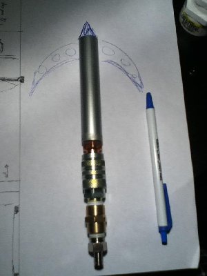

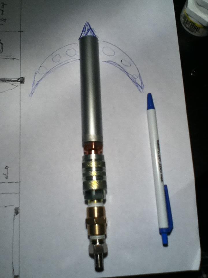

My latest project, something inspired by batman
. A grappling hook launcher that fits in your pocket (or utility belt:). Let's cut to the chase; here's what I've got so far.

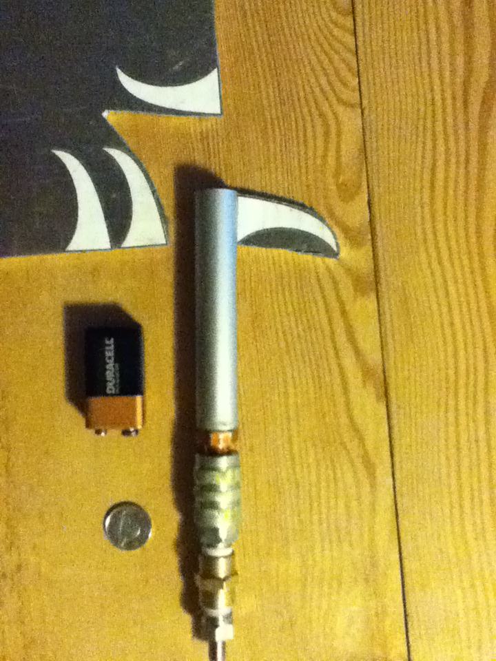

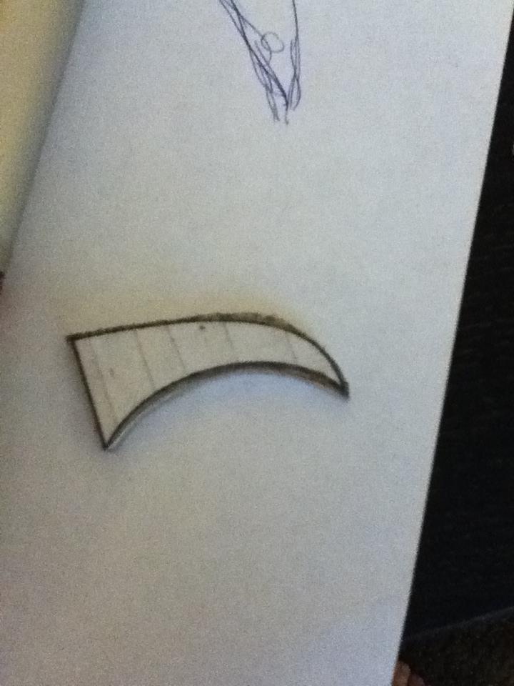

Thin ropes like you would use in a grappling hook are almost impossible to climb. You'll probably want a crank hoist of some type, realistically.
I'd go with steel for the hook itself, since aluminum doesn't give much of a warning before it breaks.

Do you simply undo the QD fitting to shoot it? If so that's quite a short "barrel" and you're not going to get much range from it, even at high pressure.
You might want to consider boosting it like pneumaticcannons did with his ballistic knife: http://www.spudfiles.com/forums/prototy ... 23451.html
No Zeus I didn't
and I'm not as out of shape as I make myself sound (I troll from a row boat). Quite a while ago somebody here did a really nifty "coaxial burst disk" launcher that used a hallow projectile to "extend" their barrel length. Anyways I really liked it so I might borrow from that.
Jsr, Its just a quick connect fitting with a Schader on the female side and the "chamber" (projectile) on the male. So my "barrel consists of a quick connect valve.
I just got home from work (epoxied before I left) and tested it at 300psi and measured out 22ft at about 30 degrees which isnt to bad for a quick connect. I added a 5" section of 3/4" sch 40 PVC which happens to make an ok barrel and got a distance of 50ft at approx 30 degrees.
Because I originally distrusted my Al chamber I sleeved it with 1/2" Cu just to be safe but we all know safety adds weight and it didn't explode there was a 1/2" section not sleeved) so I will keep that in mind for then next iteration.

As for the fins, if you could pull something like this off, I might be impressed
But srsly
Magic devices they arean annoying air bubble formed and prevented me from filling the chamber with water.
But srsly
Yeah, I fall a little short in te funnel department but I've got a few tricks up my sleeve.
In regards to te rpg video I think we're getting a little off topic here. Spring loaded fins are a bit much for this prototype. Il be making another projectile (all alluminium and a hell of a lot lighter) where a heavier medium and stabilizers will be a must. But after seeing how others have gone about building ballistic knives I might adapt such designs for my original purpose:pretend to be batman XD
Also now you've got me wanting to scake up my projectile into an Al water rocket
[/b]
