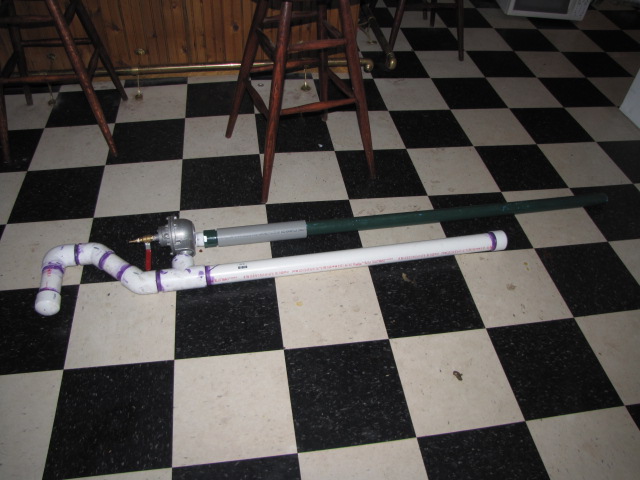

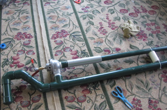

It isn't finished so I not going to put in in the showcase section yet but when it is I will. I made this to thank Mrcrowley for helping me with most my projects and answering my questions when I didn't know what spudfiles was. So big thanks Mrc45.
Here is the finished product of the gun. Thanks for the help Matty and thanks for the design Mrc45.
SPECS.
2 inch by five foot chamber.
5 foot sdr-21 golf ball barrel.
1/4 Ball valve pilot.
Quick connect fill.

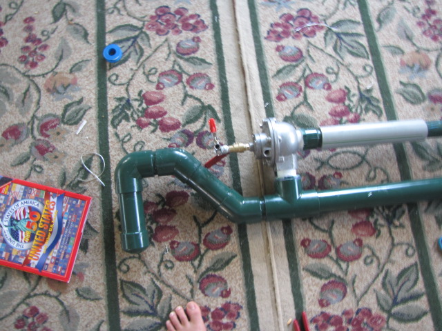

Breach load.Add heres the cannon. Needs paint lol.
Jesse brought this to mind. I forgot to thank matty for all the help on this gun and finding the valve and answering my questions about it. So big thanks to mattyzip77 as well.
My energy calculator says its hitting with
566.74 Ft/LBS and 768.40 Joules.
(video)
.[youtube][/youtube]

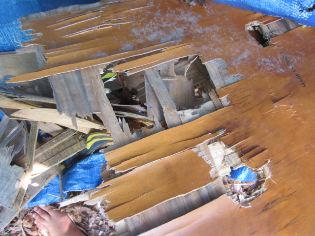

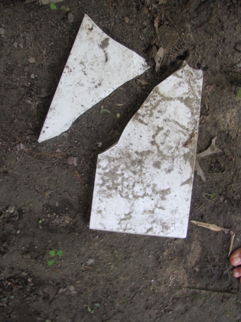

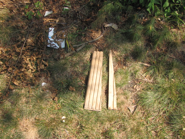

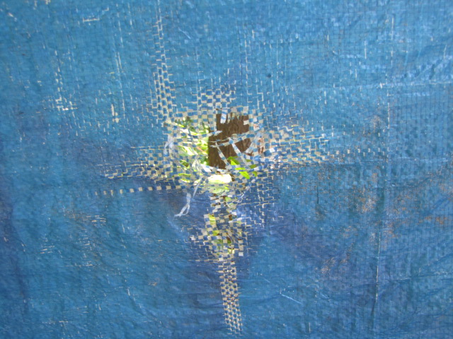

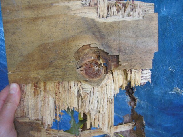

Damage video.
Maybe 1/2 inch ply wood.
pool tarp 30 psi.
pool tarp 30 psi.
Azec wood.
Azec wood.

Looks very nice! A nice coat of paint and that could look real nice. :)

that is very nice, pretty how i want mine to look.
Quick question what valve is that and where can you get one??

I have the same valve you can get them on eBay they are called dust collector valves but eBay lists them as pneumatic relief valves

Very nice design 8ton I like it. Hope you enjoy the endless.fun of putting golfballs into space!!@ jsr the valve is actually a goyen but I love the pic!!

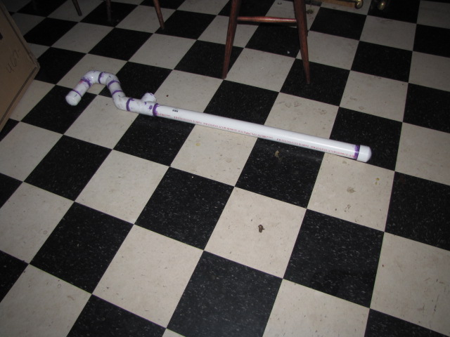

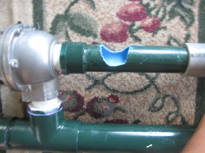

The reason I made this new one is because the green gorilla cracked from over tightening. I was having trouble with leaks so I tightened it so more and crack. Does anyone know does lighter fluid eat away at pvc. And how many rounds of teflon tape should I use on my joints. I googled the two questions but I couldn't find a good answer.
And thanks Matty.
mattyzip77
Posts: 1249
Location: Taxachusetts
Why would you put lighter fluid on pvc?? I would think it might. As far as teflon tape goes it depends, thats one of them things you gotta eye ball, better more than less though.Any type of pluming is suppossed to be SNUG not TIGHT. A 1/4 to a 1/2 turn past snug is how plumbers tighten fittings. what piece cracked?? If your only loosing a few psi I wouldnt worry about it.

To get off a sticker and I wiped it off right after i got the sticker off. And i'm just not going to use the other chamber.

No harm done but next time the pvc primer will work just as good if not better than lighter fluid for stickers.

You can crack a perfectly healthy fitting by overtightening it..
Spaying icecold lighterfuel on it is probably not going to help..
