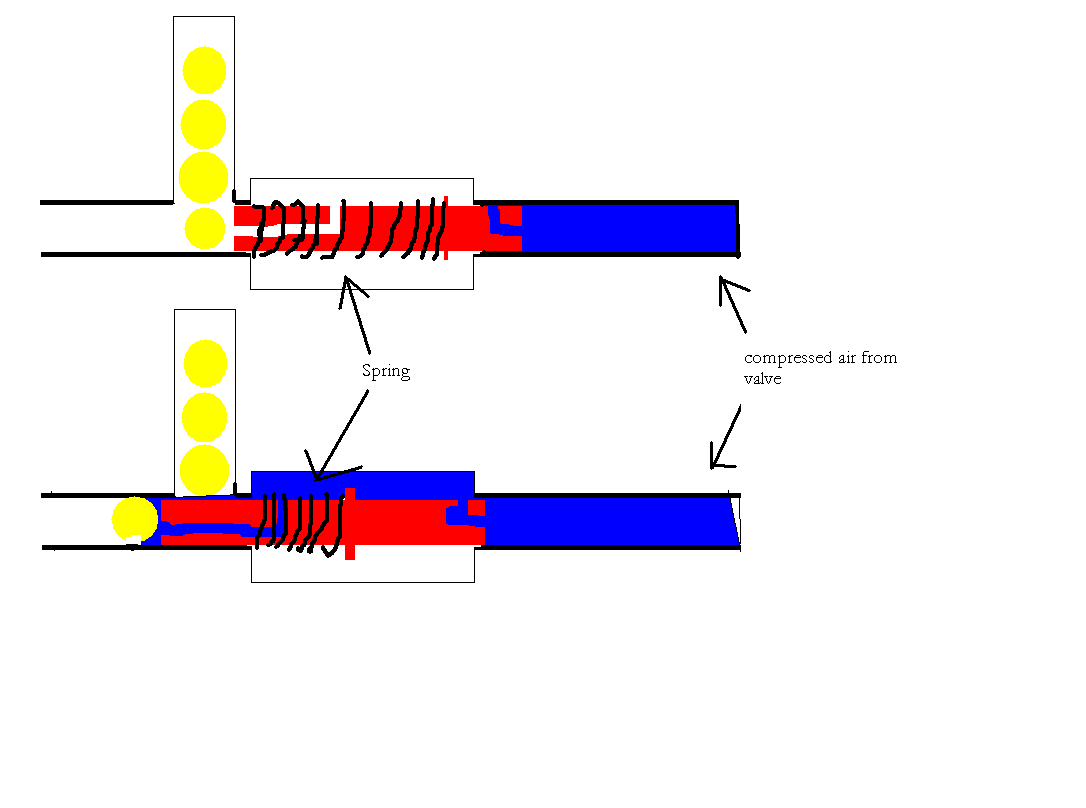

This isn't exactly what you asked for, but it is a proven system; many people have used it for BB/airsoft or even larger cannons. Sorry, but my paint skills are horrible.
- Blow forward bolt
- Blow forward bolt.PNG (26.19 KiB) Viewed 4937 times

The only problem with that, and imo ALL blow forward bolts is that pushing the red block forward would hinder the speed of your air, similar to adding a bend in the airflow from the source to the barrel.
