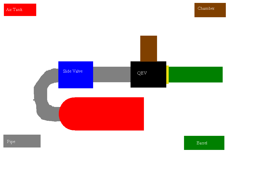

Is your air tank directly connected to the QEV? Here is a diagram of a QEV semi auto system.
@Zeus LOL :lol:
This is a common semi auto system for a QEV

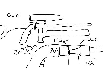

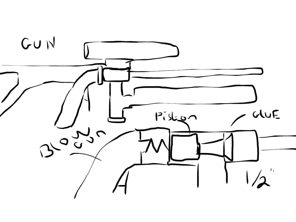

Alright ! ... The Pilot is where it dumps the air to open the QEV valve through a blow gun (Rated at 150psi) ... the pilot has a nut that can be undone and tightend to measure the bursts of air but at the moment the pilot comes out and blocks the blowgun which is good but my piston in the QEV is staying open and losing all the air from my cylinder ! .
Zeus ... im not a complete retard please be nice !

You also need an equalization hole in the diaphragm.
And I am nice, you just gave the most vague question I've heard in quite some time.

Ok Bud I sort of get your diagram ill upload what im trying to say with paint :)

dahakka
Posts: 57
Joined: Sat Oct 29, 2011 3:43 am
is that a homemade piston valve?
i try to get multishot with my homemade piston valve like that before
it's suck
because the vlave's sensitive depend on your piston quality , want semi auto the piston must perfectly fit, moving easily, and good sealing face, of course
so , buy a qev , a blowgun , push it sightly..... something like BTB say in some thread , i don't remember
or make a hammer valve
it's easy to make too :lol:

Finally someone that helped thanks buddy :) ... ill try a tighter piston and a stronger spring if not ill buy a QEV :)
