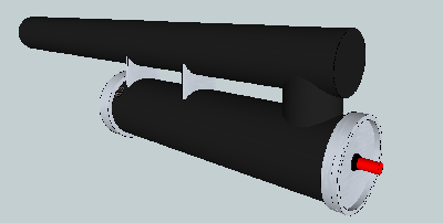

hi, just a quick (quick for a pro, VERY long time for me.) mockup of my new, simple cannon, looks pretty cool though, switch on the front is for fan, rear is piezoelectric ignitor, i personally like simple designs., should be done reasonably soon if i can find all the parts.

Nice, good job on the CAD. But if you are looking for simple and lots of power, then BUILD A PNEUMATIC CANNON! :D

What program did you use? Looks pretty good! I'd say upgrade your pneumatic cannon first and then build this.

Power yes, but combustion cannons are much more common and easy to build.

To be honest, i do much prefer combustion, mainly because it takes much less effort as everything does not need to be perfectly sealed, and because i just cannot understand Piston valve (or cant be bothered to understand them)
EDIT: I used google sketchup to do this

You could get more power by
- using a longer barrel
- using a faster valve (eg. QEV)
- using higher pressure
And a few more but those are the simple ones.
Just a note on your original combustion design- if you want to set the cannon barrel-up then you'll be setting it on the piezo which could accidentally fire it.
