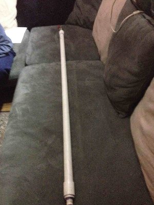

So anyway the cannon, its nothing special just a coaxial piston cannon. its my third piston cannon but its the only left intact. the original idea came from the "mouse musket" I'm sorry but i can't remember who it was who made it but the credit is his for the concept.
*Technician1002 Thank you for your help, This community has taught me a lot over the years with out even knowing it. It is appreciated
Sorry i can't post any damage videos at the time it is much to cold to shoot a pvc cannon.
Specs.
Barel: .5" sch 40 pvc
Chamber: 1.25" sch 40 pvc
Piston: Epoxy cast w/ Rubber seal
Pilot: .5" Ball Valve
Length" About 6'

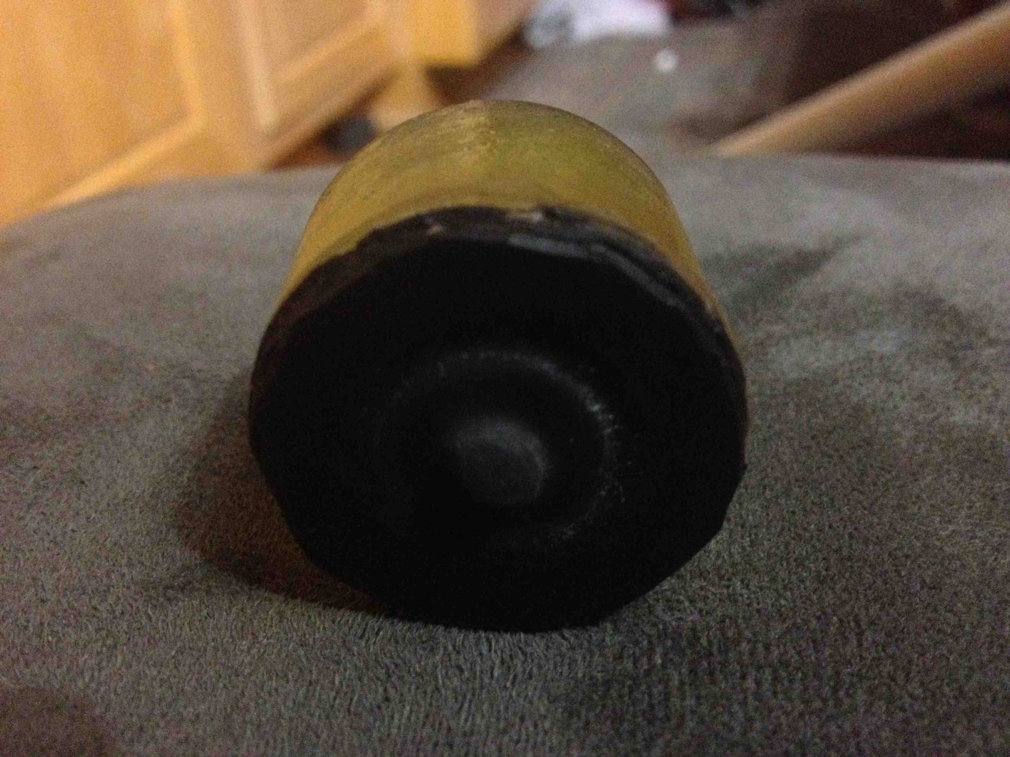

+10 newbie points for a well executed epoxy piston, nicely done

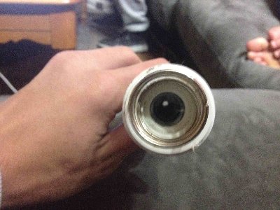

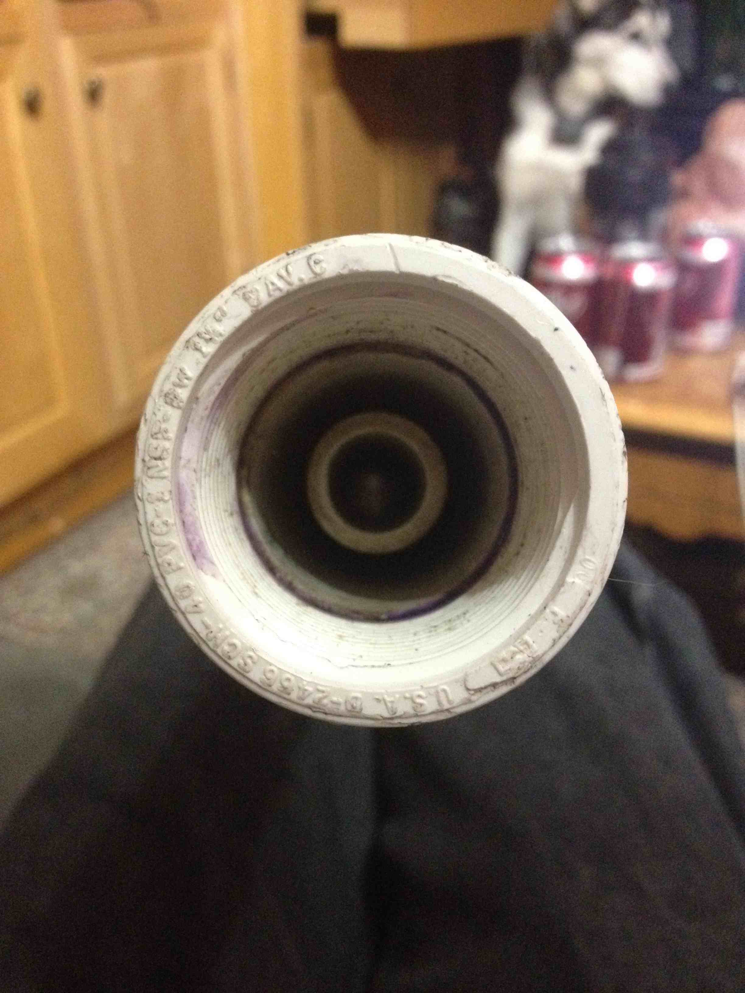

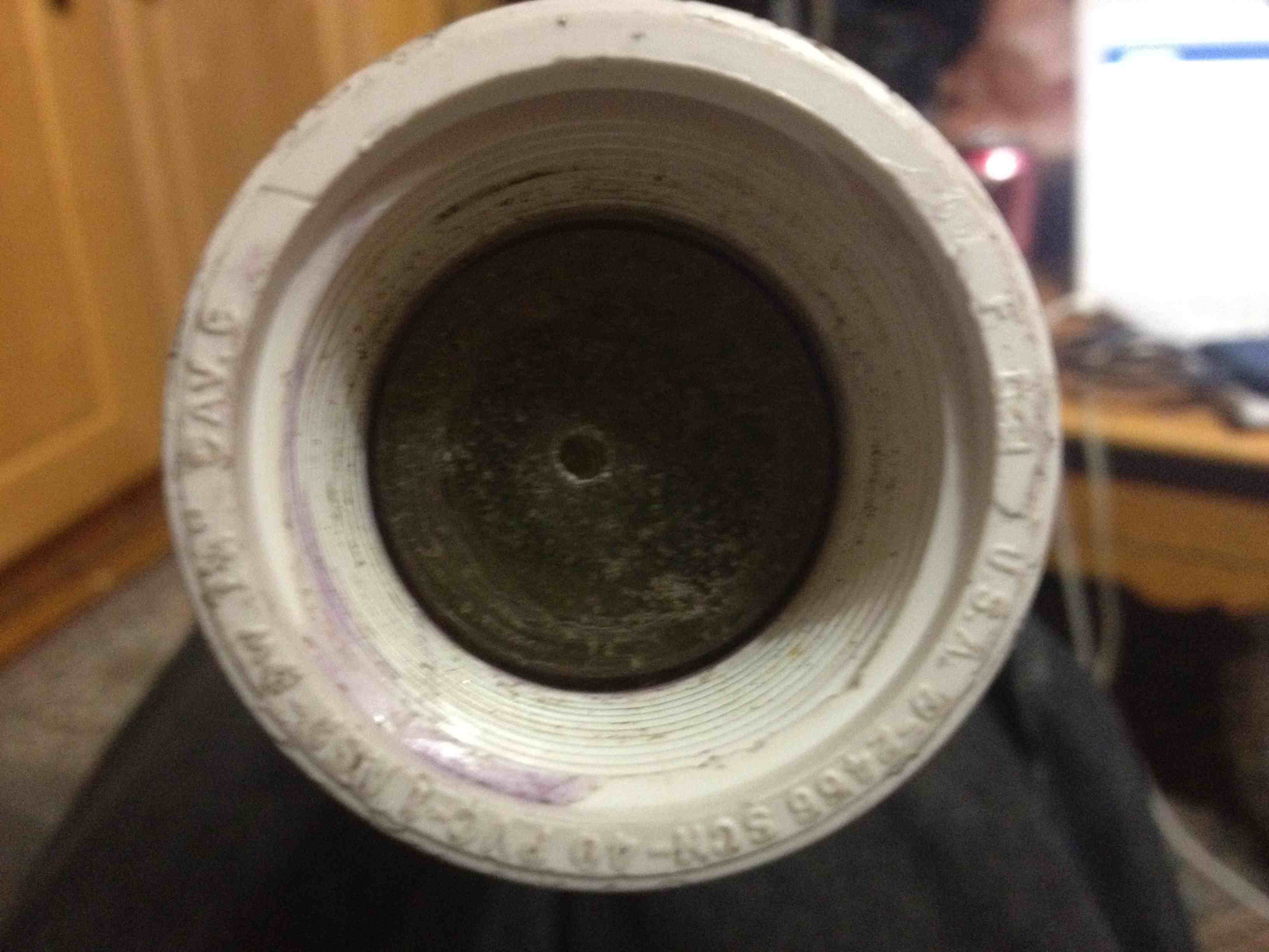

Is the barrel provided with some sort of support to keep in centred in the chamber?
Thank you i tried a bunch of different pistons but this is the last one, its lasted about 2 years so far
I had more pix but most wouldn't compress, yes there are 3 screws holding the barrel centered.

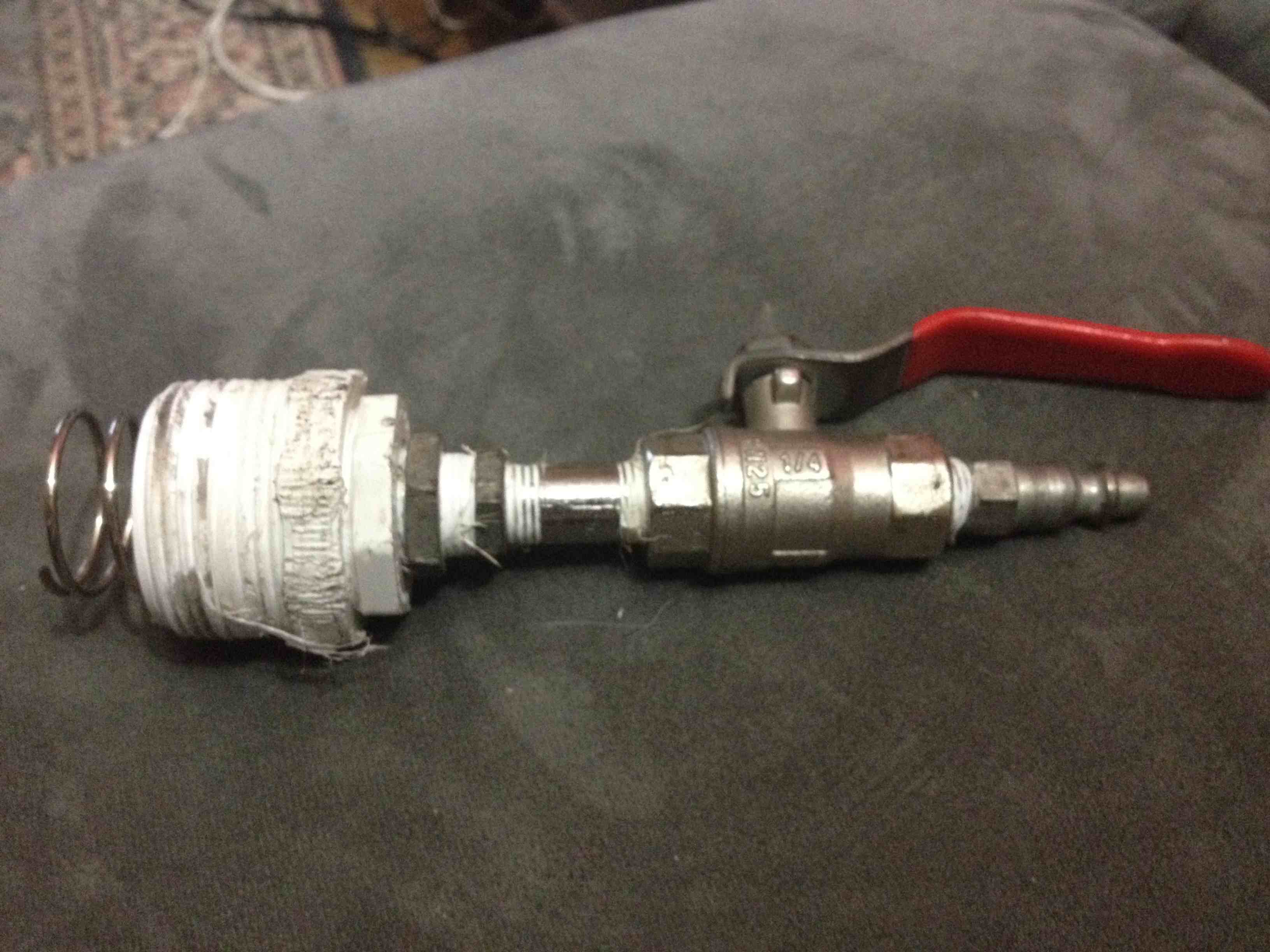

Well done. When you think you have enough bumper, add more. The Mouse Musket broke 3 pistons.
For some reason bumpers have never been a problem for me. This piston has been taking 130 psi shots for about a year and a half now. Plus the piston has very little movement < 1/4". The spring is more or less to keep the piston seated.
