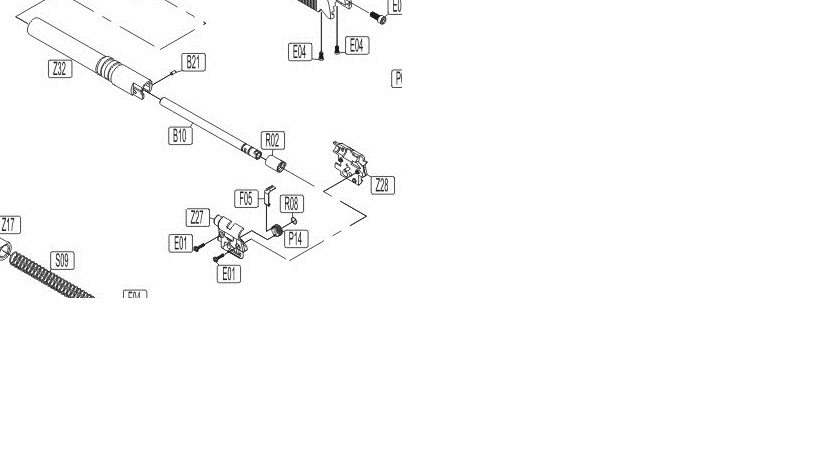

Don't have a real picture with me, but parts Z27 & Z28 on the attached diagram are the ones I'd like to replicate. Thanks!

The is a Cybergun/KWC Tanfoglio Limited Custom CO2 6mm.
I've had problems with it from the start, trying to get replacement parts got me nowhere. So far, I've had a cracked slide (my friend's shop managed to laser-weld it), ripped hop up rubber, broken rear sight, and now the left side of the hop up unit snapped in half. I'm trying to keep it running until I find a reputable dealer to buy the replacement gun. Here in Canada we only have two surplus stores that sell this model.

parts Z27 & Z28
Valve housing loading tube? combo???

The part is a hop up unit: it holds the inner barrel, hop up rubber, and an adjustment bracket. Since I already made my hop-up non-adjustable (I shoot at 5-7yards at scaled down targets, and don't need any hop-up), I'm thinking of modifying the unit by making it a solid 2-part shell that holds the barrel, hop-up rubber, and nothing else. This may simplify the design, and make it more solid.
