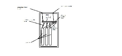

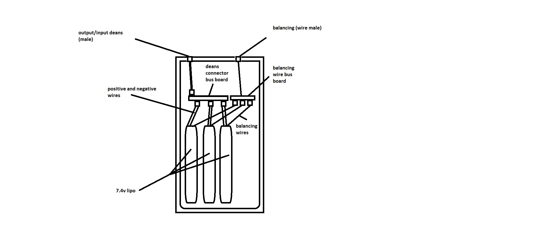

OK here is what i have come up with so far
