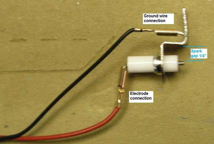

Has there been testing on the best location for a plain hair spray combustion spud cannon? Let's stay simple and a straight combustion chamber inline with the barrel. Should the spark be closer to the potato or the back end (capped)?
My first build has a 4" combustion chamber with 17" cut length of pipe and the end fittings (see avatar) for an effective length around 19".
I have two barrels so far (screw on), both are 2" dia, 49" and 73" long with the screw fitting. My spark location was not thought out, and it happens to be mounted 13" from the end cap.

If you're worrying about performance, then ignition placement isn't really the place to start. I would focus on the proper metering of pure fuel as opposed to using hairspray, as well as a chamber fan to ensure good mixture.
For ignition, you ideally would have multiple ignition points. Have a look here: http://www.spudfiles.com/spud_wiki/inde ... park_strip
In that series of posts, a link to test that "Insomniac" did with a clear soda bottle shows the flame propagation of actually moving the igniter.
He did say, It's important to note that not all the varience in flames was caused by spark location, as the mixture was varying significantly from shot-to-shot.
The only conclusion I could see was the rear spark provided the fastest flame propagation. And that implies more push, for a spray and prey, without a fan.

I would take that conclusion with a grain of salt.SpudMcJim wrote:The only conclusion I could see was the rear spark provided the fastest flame propagation. And that implies more push, for a spray and prey, without a fan.
Firstly, there isn't any back pressure and no barrel so the relevance to a typical gun is questionable. In a gun with a barrel and ammo a fair amount of combustion occurs before the ammo starts to move. You then probably get some turbulence as the ammo starts to move and the gases, burned and unburned, start to move.
Secondly, the rear spark only gives a single flame front. For that to be actually faster combustion that speed has to be greater then the sum of the flame fronts' speeds for a central spark.
