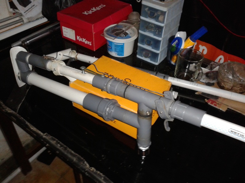

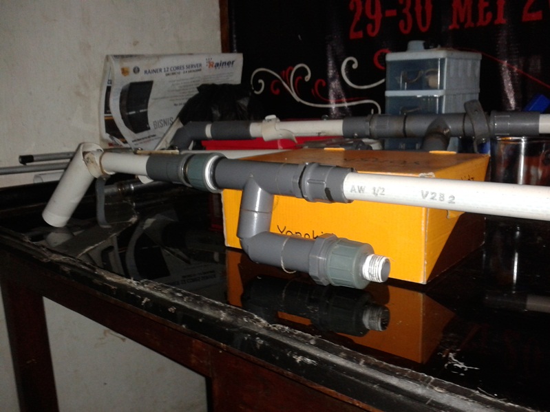

Here are two of my guns, both have similar system, piston valve with hammer valve for piloting.
I'm in the country with very limited access for advance material and online shopping so I try my best to use the ordinary PVC and any stuffs I could get in my garage. I use those guns with 80 psi max since that is the max pressure I could get with my air compressor :(.
Here are the pictures and sorry for my English.

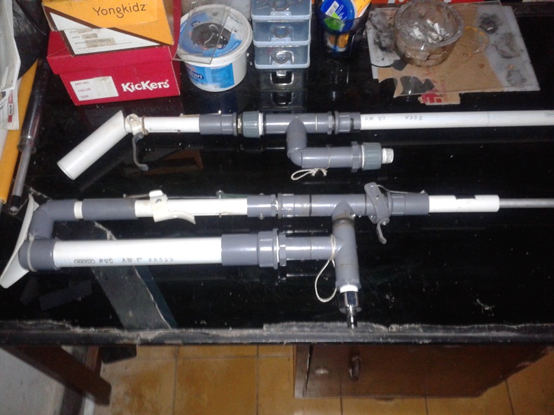

upper the old one, lower the recent one

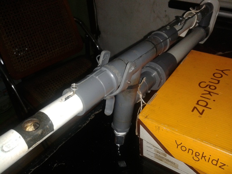

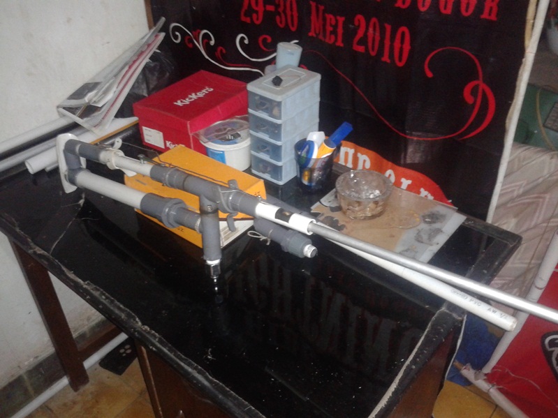

a simple gun
a simple gun
this recent one originally used half inch muzzle loading barrel, the same as the old one. But then I found a barrel from my last experiment with blow forward bolt, I just change it into manual push forward.
the trigger release the hammer and  push the bolt in the same time
with simple muzzle loading half inch barrel

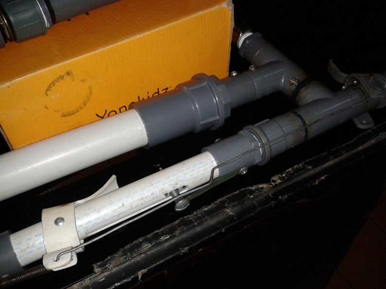

triggering close up, that rubber band is supposed to be for temporary, but then I realize it is a cheapest way to experiment with hammer power. That rod absolutely will be replaced.

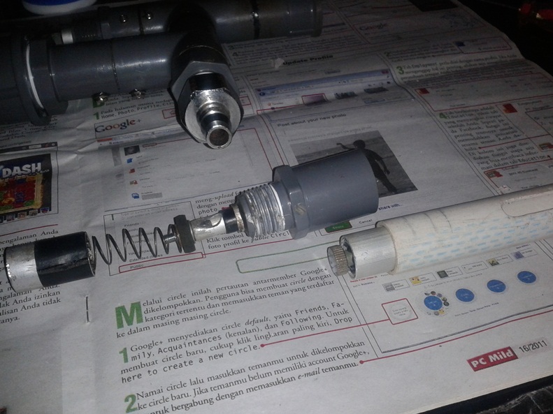

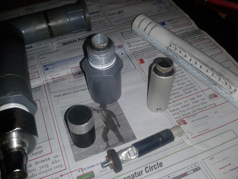

the piston valve, hammer valve housing, hammer valve steam, the hammer, and the hammer tube (unfinished)
hows everything arranged inside the gun
