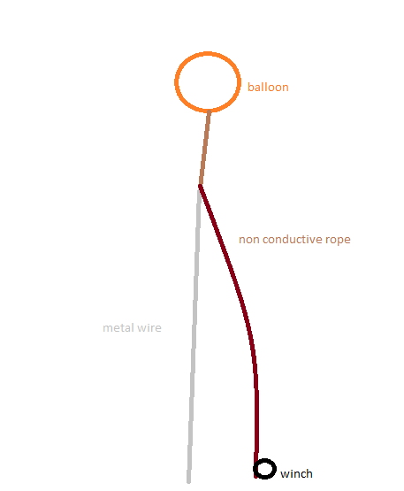

I wonder if this would work? I remembered the whole story with Benjamin Franklin...
You could use a hydrogen balloon for moar awesome!
