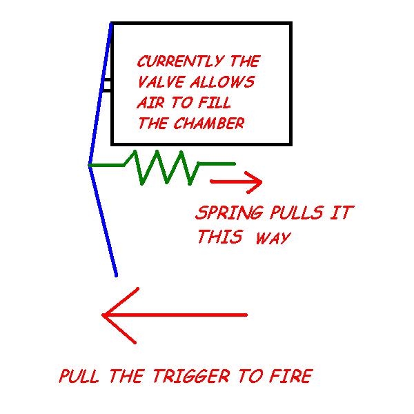

technically it's it possible to use a normally closed valve too. You just have to build a simple trigger system that keeps it pressed when the trigger is in normal position. Damn it hard to explain it using words so here's a diagram
The added advantage is that NC valves are easier to get and you can make a more comfortable trigger
- madiagramzrszittyIknow.JPG (36.67 KiB) Viewed 7364 times
Yep, brian suggested something similar in the original thread.
What pressure do you intend to fire at? These are probably good for at least 300 or so psi.
