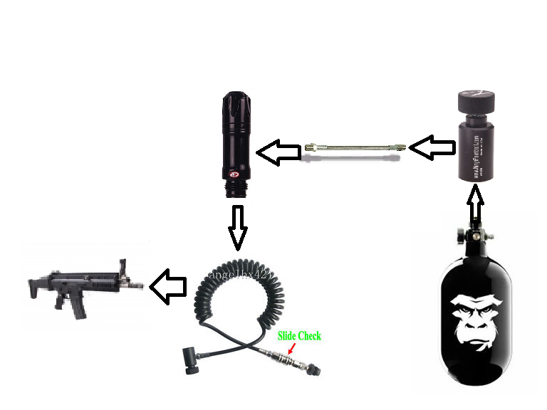

Will this work?

You can use a ninja paintball tank.
Their SLP regulator can go down to 300 psi: http://www.ebay.ca/itm/Ninja-Paintball- ... 1110666589
This would save on getting a separate regulator, you would only need the remote line and tapping your magazine for the quick connect.
On a very hot day, Green Gas can go up to 200 psi, so with 100 psi more than that you would still be risking too much power and strain on your GBBR.
Finding a base gun made for CO2 would defnintely be a good idea.
