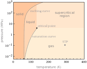

Ah, yes I forgot to consider that. Using hydrogen, which won't liquify until it reaches 800 BAR would be more efficient, but air liquifies at about 250 anyway.

individual wrote:Ah, yes I forgot to consider that. Using hydrogen, which won't liquify until it reaches 800 BAR would be more efficient, but air liquifies at about 250 anyway.
Nah, that's well into the supercritical region for air:
One possibility I did consider a long time ago was a H2/O2/He mix. While the helium wouldn't directly contribute to the combustion energy, a certain percentage of the mix being Helium could improve the end results.
GasEq predicts a very similar end pressure for the combustion of a mix of 2H2: O2 : 3He as it does for 2H2 : O2 , even for the same starting pressure and volume (and thus only half the fuel), but it also reduces the density of the propellant by about a third. And, as a general rule, the lighter the propellant gas, the more efficient it is.
I'm not sure if Utron do or don't do this (and why they do or don't), but it's potentially worth an experiment somewhere down the line.
