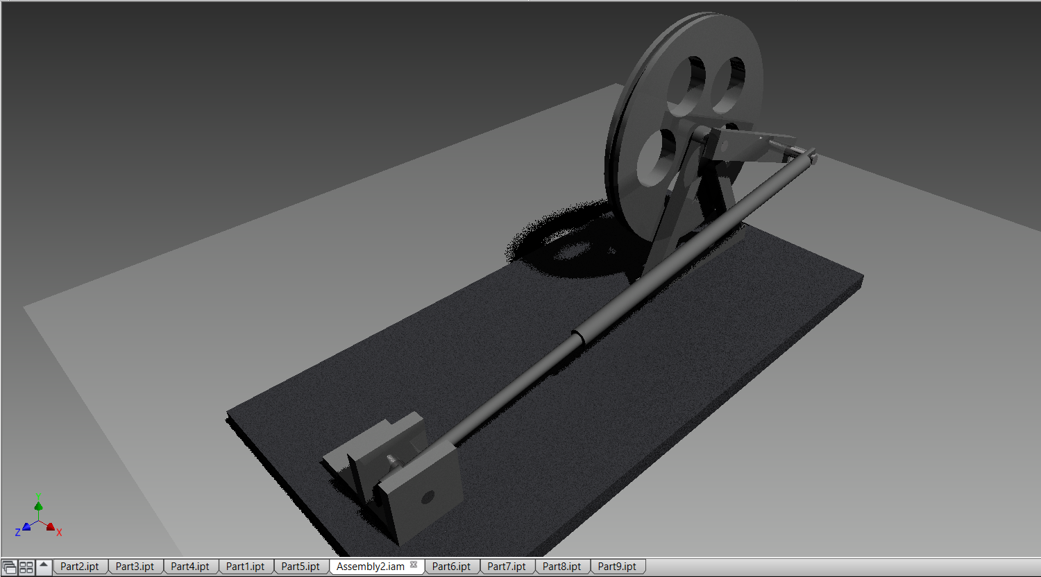

I decided to make automated "thing" to drive the pump, as shown in picture.
Datas: Distance between pump fully extended-retracted is 44cm, so the length of that arm link to the pumps is 28cm, 22cm between the two axis; The wheel diameter is 30cm, the wheel on the electric motor is 5cm diameter (not shown, because I haven't decided what kind of motor I need).
The arm has a thickness of 2cm, the triangular support has a thickness of 3cm and so does the wheel. I'm planing on use aluminium for everything.
So for the pump to reach 3000 psi my own weight(60+-) is not enough, I've to take a little "jump" to push it, so about 100 kg to push it down I think?
My questions are: will the structure be able to hold it? I see some distortions :? Also what kind of electric motor do I need (what are the specifications I need to know, like torque, rpm etc)? It doesn't have to go fast, 10 cycle per minute is perfectly fine.

I like what you are thinking.
Have you considered the problem of heat?
With a few pulleys you can reach the force you need but by the time it's all done you might have been better off building a short stroke pump from scratch, something like the shoebox compressor.
Can you add weights to your pump handle? That way you share the manual work between pushing and pulling... may void warranty

Yeah, add a little fan would solve the heat problem.
I know just few pulleys it maybe technically strong enough to pump, but my concern is if the structure is strong enough to hold together.
The pump is 3 stage, kind hard to make something like that, I can avoid all these pistons and check valves.
The pumps is 3 stage, you compress air by both pulling and pushing, so add weight won't solve the problem.

Straddle the pump inbetween 2 half-weight flywheels to rid yourself of the moment arm created on the side right now if you can. That will make balancing out the forces much easier. Use some heat sinking on the compression chamber of the pump and the high pressure line out if you can as well to alleviate the heat build up which will be inevitable when compressing air.

@mobile chernobyl can you draw a simple diagram? I'm not sure I got the right idea :s

Oh yeah, basically I got lazier and decided to "simply" the pump part, also the hill pump is faster than the shoebox compressor. Anyway, how am I going to decide what kind of motor I need?

These are nice, I' trying to make a copy. The motors used obviously have a gearbox which I'm having a hard time finding one. Got the idea of using a electric hoists which has low rpm and high torque.
Now the hoist has the cable wheel with a diameter of 10-15 cm while I need 44cm Dia to swing the pump. The model is said to have 250 kg lifting capacity so since the arm is about 3 times longer the force is 3 times lower right?
