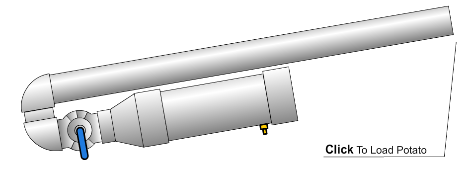

My mission is to build a launcher that will launch a tennis ball into a basket. The basket will be placed at 3 different distances of 3.0, 5.0, and 10.0 meters from my launcher. My launcher must be free standing. I will not be allowed to support your launcher off the ground as I launch. Combustion may NOT be used
. Here are the requirements for compressed air. The holding tank for the compressed air may not exceed 2 feet in length and 3 inches in diameter. No more than 60 PSI may be used for launch. (In theory, how far will this shoot based on your experience?) All materials used must have a pressure rating of greater than 100 PSI (Easy). The labels on the materials must be visible upon inspection. All junctions must be sealed per construction standards (i.e., PVC joints will be inspected for proper primer, glue and proper seal.). How do I seal the "Schrader Valve?" The holding tank must have a pressure gauge on it so that the instructor can ensure that the PSI limits are not exceeded and that the tank has no leaks. Keep in mind that this is for a tennis ball.

You made no mention of firing valve...Any restrictions on that? You can use a metal Schrader valve, they are threaded just use teflon tape to seal the threads and placement should be through double thickness PVC area.

Sabercat wrote:What is you recommendation for the valve from the air chamber to the barrel? I need something that is consistent because we are running 3 trials for each target. And the accuracy is our grade.
Spring loaded ball valve. Lube it up to make it turn easy.noname wrote:Getting a consistent valve that will seal at 5 or 10 psi will be the trick since that 3 meter shot sounds tricky.

Question, is launcher modifications permitted between shots for different distances? If yes, instead of a burst disk, a union contaning a hand crafted throttle restriction plate would provide very consistant launches at a fixed pressure high enough for reliable sprinkler valve operation. Remember that repeatability is key. Elemination of variables is critical such as various pressure, valve response (hand turned ball valve) etc.
Start with a blank metal plate cut to fit in a union to block the flow and drill 3/8th inch holes and test your distance on ~40PSI. If close to one of the target distances, trim the distance by adjusting the pressure. Place the flow restriciton between your valve and barrel, not the tank and valve. Change hole sizes and number to get consistant shots for your distances at ~40PSI. Fine tune with pressure regulation. Good Luck.
The short close shots can be the hardest.

For a tennis ball launcher, 1 inch should be the minimum valve and plumbing size to consider. 1.5 inch is even better. 2 inch becomes hard to find and expensive. Don't bother. It is better to be oversize and dial back then undersize and unable to reach your target.

A smaller sprinkler valve might be better. Since your max range is pretty short, only about 30 feet, you really shouldn't need the much more expensive 1" or greater valve. Heck you can underhand lob a tennis ball 30' without any problem. Usually though when people build a cannon they want to launch something considerably farther than they can throw the object.
Download GGDT (Gas Gun Design Tool) and play with your dimensions, pressure etc. I would design the gun so the 10 meter shot is nearly the maximum the cannon can do. That way you might be able to do the shorter shots just by changing the launch angle (if that is allowed) or by lowering the chamber pressure if you have to use a fixed launch angle.
