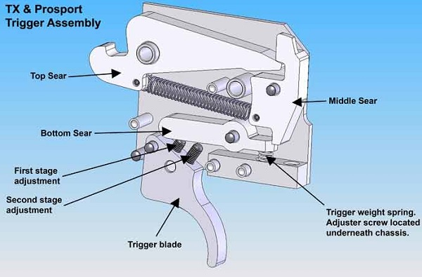

On the subject of friction being a problem with opening, this issue is solved in some machines with a huge amount of friction, for example, ye olde crossbows simply by having a long trigger which gives a lever advantage against the friction from an immensely strong bow, I'm wondering if the same could be done here.
That would definitely be a solution, a perfect mechanism to imitate would be the trigger of a spring airgun:
