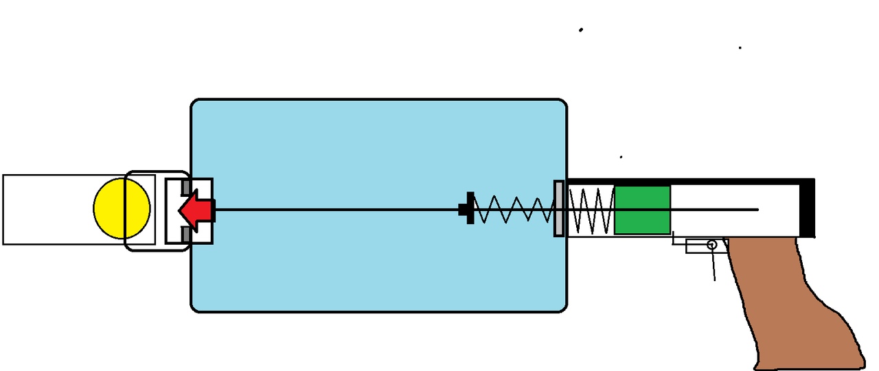

But what I did. A pistol with a balanced valve as in the picture. I pumped up and 100 atm, but the best bullet speed starts from 70 to 50 atm, from 160m / s to 130 m / s. The number of shots is 30.

Impressive the two weapons. Really very inspiring for me :bounce: . The simple and effective construction, and with limited means, is the best. Excellent post regards :)
You can use a neodymium magnet so that the ammunition does not fall.
keks2033 wrote:But what I did. A pistol with a balanced valve as in the picture.
Very nice! The vertical valve reminds me of the Weihrauch HW40/Beeman P17:

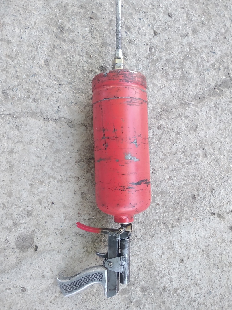

My friend made another gun. It is made of a fire extinguisher, the valve is balanced. He made her keak toy for his younger brother.
That looks like it could be a very dangerous "toy" at higher pressure... still, looks well made!
