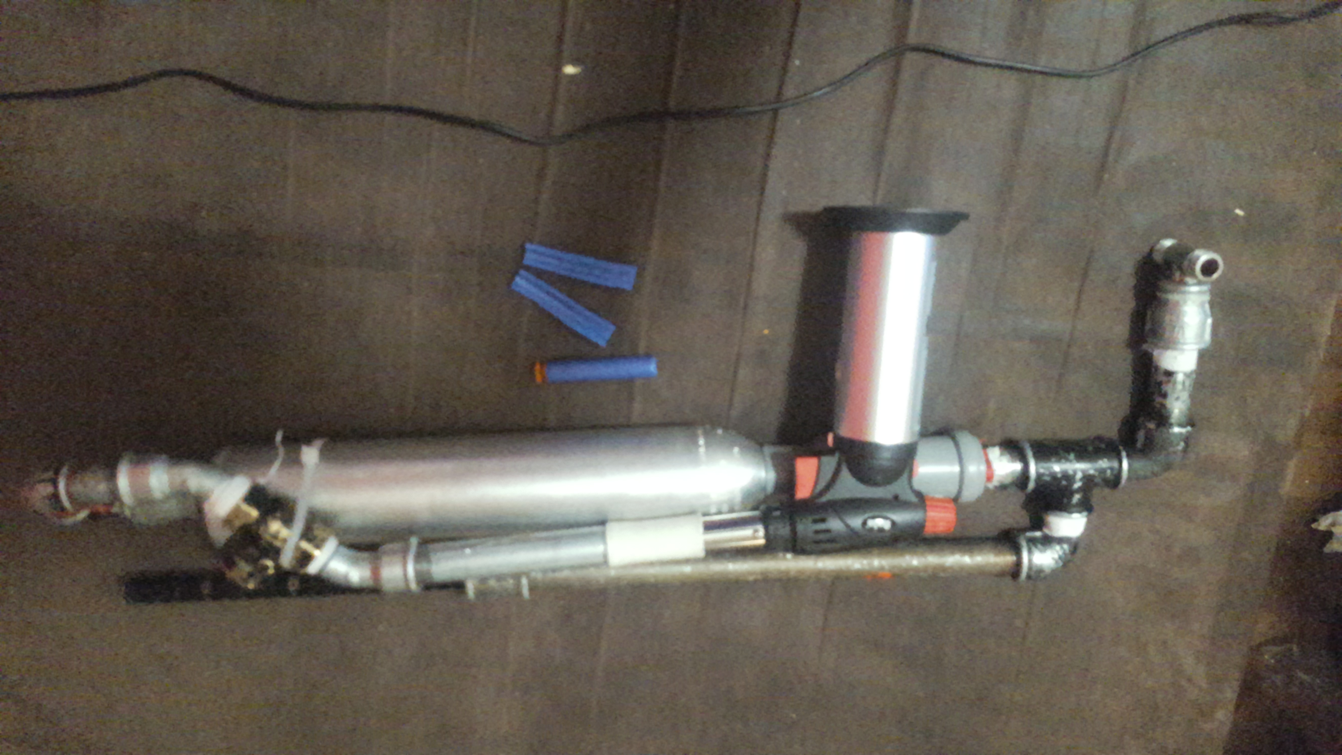

I ever had the problem, to get the mostly perfect mixture of a Butane Torch inside the combustion chamber with a loaded and seled Barrel, and sealing the way back after ignition WITHOUT using electronics.
So, its very simple: You need 2 valves in this simple system and a little overdimensioned combustion chamber ( the pressure shuts first the valves and then the pressure has only one way: out of the barrel.
The first valve is simply a blowback valve. it closes in one direction. It is diagonal, because it only shuts of for a very short time. mostly open.
The second valve ( i will add pictures) is a simple valve, that shuts at overpressure. Its open for leaving the mixture in, but once there is pressure after ignition, it closes. This 2 Valves are the miracle.
It is very loud. And you can see on the pictures: the most darts explode and only the rubber hits^^ Foam works like a shell^^
I will make Video outside.

Nice, but we're gonna need some more pictures to explain what's going on here. ;)
