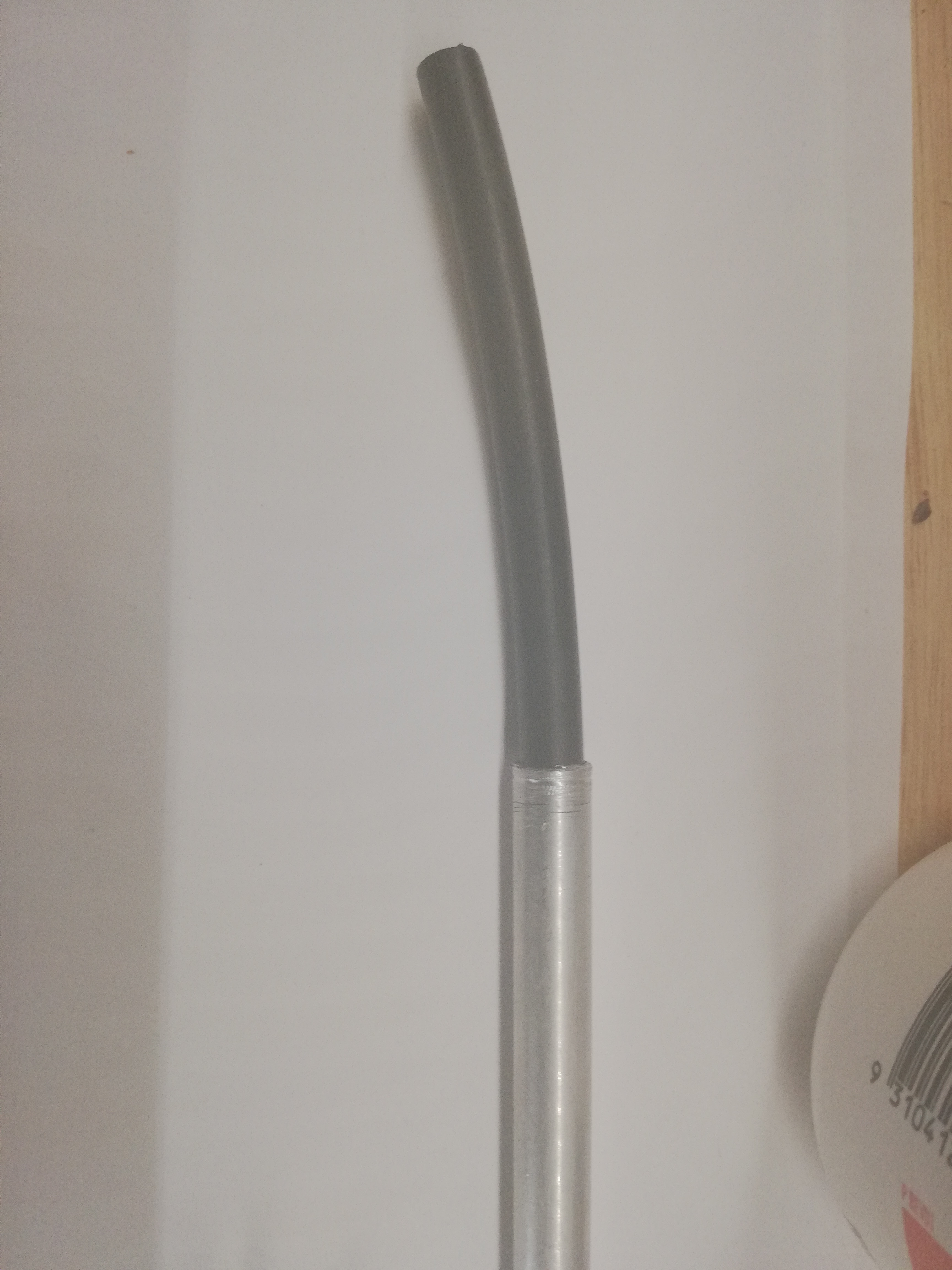

One of the nice things about using a extendable SDR-21 barrel and golf balls, since the barrel droops somewhat under its own weight, the ball actually starts to roll along the top of the barrel causing backspin on the ball and a perfect "drive trajectory" with that beautiful arched rise....and then it's gone, never to be seen again. ;)
And when you shoot it straight up, it takes the ball around 25 seconds to return to Earth... Count that out!
