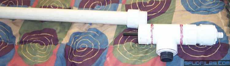

<img src="http://www.spudfiles.com/official_pics/ ... Barrel.jpg">
This is Universal Breech Loader. With proper fittings on the barrel it allows this one breech loader to work with barrels ranging from 3" Sch80 to 3/4" SDR-21. It's built out of a 3" tee and uses modified sockets on the tee and the 3" threaded adapters on two legs of the tee. The third leg has a 3"x2" (SxT) bushing with a 2" threaded pipe nipple glue in to fit onto any gun with 2" threads. I use a 2" street elbow (TxT) to use it with my guns (mainly the STAG5) to use it in an over-under fashion. The breech end cap is a 3" male threaded end plug with a 3x2" bushing, a 2x3/4" bushing and a 3/4"x1/2" bushing with the pipe stop filed out. A 1/2" end cap is placed on a short section of 1/2" sch40 that goes through the mess of reducers. On the other side reducers a 1/2" female threaded adapter was glued. To this a 1/2" polypropylene sprinkler riser is threaded that serves as the breech ramrod.
The UBL is shown with a tennis ball barrel w/ 3" male threads.

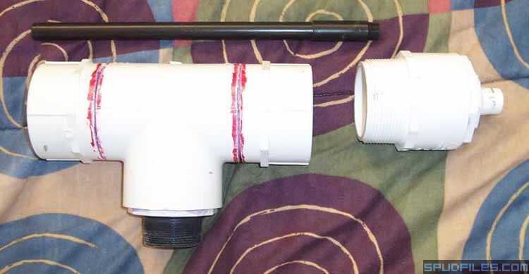

<img src="http://www.spudfiles.com/official_pics/ ... embled.jpg">
This is just a close-up of the UBL without any barrel. You can see the three main pieces, the body, the end cap, and the polypropylene sprinkler riser (mini-ramrod.) The red lines were used by me to attempt to cut the sockets as square as possible with a dremel (which melted the PVC even at the lowest setting.)
