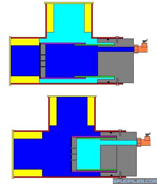

<div align="center">SUPAH VALVE MODEL
Provided By Christopher Denis - <a href="http://www.geocities.com/spudgunsnh/">h ... gunsnh/</a>
About How The Supah Valve Works
The Supah valve is a piston valve and cost around $30 to make so making your own will save you some money. but you will need a lathe and 3.5'' solid PVC 3'' T drill and other hand tools. This is only how I think the Supah valve works give or take a few O-rings and the return spring. If you have suggestions, comments ideas? E-Mail me Cdenis29@msn.com
NOT TO SCALE!
Valve is closed, filling up...

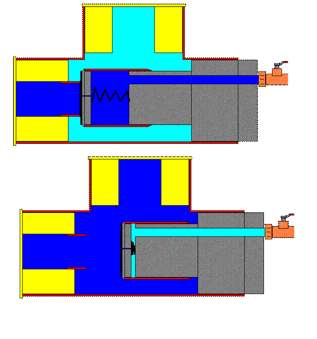

Valve has just opened!
Here is another older model of it.
<img src="http://www.spudfiles.com/official_pics/supra.gif">
Quote from Tim B. (Has watched Joel put one together)
"your valve diagram is good, close to the real thing, but not quite..."

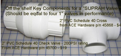

A 2" PVC Schedule 40 Check Valve is available at your neighborhood ACE Hardware store for $19. This plus a 2"PVC Cross, for $4, combining everything should make an off the shelf valve with better performance than an array of 4 sprinkler valves. I will assemble everything after Christmas and post the results.

I guess I dont get it. Please explain.
drac
Posts: 899
Location: Avon, NY
Mon Dec 19, 2005 8:48 pm
Yeah, I've seen the internals of a supah, and i have no clue in hell how you would fit it inside of a cross and a check valve. Maybe I'm losing my touch. :(
