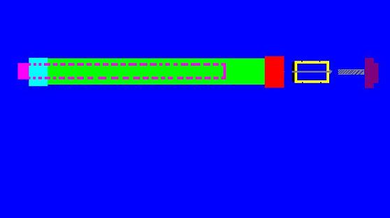

I have built 4 cannons so far... 1 combustion and 3 pneumatics. I like pneumatics much much more for many reasons (more powerful, easier to build, cooler sound shen shot, etc. lol) but now I want to move to the next level in my spudding career and i'm considering building a massive pneumatic cannon. I want to build a co-axial cannon with a large 4'' chamber and cleanout cap but what i'm not sure of is what barrel size i should use to shoot normal spuds... whether it should be 1.5'' or 2''. I am also unsure of whether I should use a piston or a diaphragm and which would be easier. I have made one coaxial piston valve and it took me quite a while to get a good piston and good seal but now it works every time. I was going to use a modded sprinkler valve to relieve the pilot but I would like some input on the barrel size and whether or not to use a diaphragm or piston... I want to be able to shoot it right at 1/4 to 1/2 mile with a spud or other object, hopefully it's possible... i'm ready for the big one! Thanks.
This is a sketch with a piston... what do u think?
cannon big boy.JPG (9.56 KiB) Viewed 7341 times

Just use a 10' length of 2" for the barrel and a 10' length of 4" for the chamber.

Ok is that a good C:B ratio? And what about the valve diaphragm or piston?

C:B ratios don't matter very much with pneumatics, but this will be 3.5:1 or around that. Doesn't really matter if you do piston or diaphragm, that's your choice.

Well ive never made a diaphragm cannon before. Are they easier to get to seal than piston cannons? And which would be more efficient for a cannon this size?

I wouldnt go for a diaphragm. I tryed that once on a large scale gun like this and couldnt get it to seal and it was all set up right..From what i've read pistons can be much better then a disk of rubber. But dont hold me to that since I am still a noob. :)

Yeah i like pistons more also. For some reason they are easier to make. It would be cool if you coul get a ten foot golfball barrel. That would go 1/4 of a mile.
