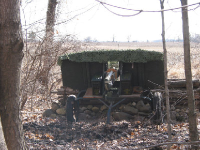

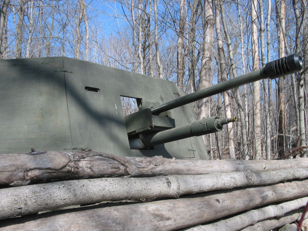

Here is another cannon I did years ago it has been a test platform for many new kinds of ammo. Sorry I don't have any updated pix of the shells it fires. But I’ll give you and idea, the shell is about 1' 3-4" long 2" in dia. At the front and 2 1/2" at the base. Only about 4" of the shell actually leaves the gun the rest is just casing used for storing powder for simulated smoke or a glow stick.

this is one of the first realistic looking over under cannons i've seen, very nice! is it breach loading or muzzle loading?

What type of valve? Oh and GREAT GUN!!

At the moment it is just a ball valve; but as everybody knows 2" ball valve like to freeze up easy so maybe I'll rebuild it someday and use a diaphragm system instead.

DAMB! Try a piston valve in a tee. http://www.bcvids.com
Go to the vid tutorials and its under barrel sealing valve.
