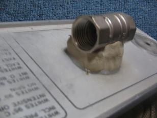

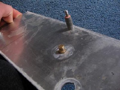

I have a 1/2 inch ball valve that I have fixed to an aluminium plate.
I want to make it spring loaded with tension springs but do not know how to go about doing this.
I would like to include a trigger in the design as it is going to be an exhaust valve. I need some help with making this.
This is attached with putty and adhesive.
ball valve&plate.JPG (15.68 KiB) Viewed 5855 times
the handle was connected to here

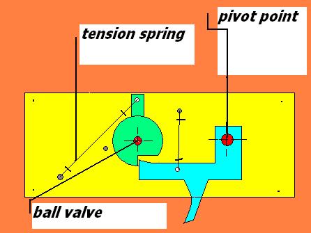

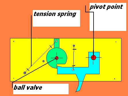

Heres a quick diagram I made I hope this is what you wanted.

How do you stop it from opening?
Sorry, I forgot to say I need to make some sort of lock mechanism. Thanks for trying though.
Forever dreaming...
Pwnany
Posts: 34
Joined: Sat Aug 05, 2006 11:15 am
Put a bolt or something sticking out of the piece of metal just to the left of the trigger in my diagram so that when it is pulled that way buy the spring it stops on the bolt so then it is closed. when you pull it it opens and well... yeah.

The only hard thing is you'll have to make a squared hole to grip the "axle"of the ballvalve.
Just drill a smaller hole and file away.Or you can leave the handle and attach a plate to it in the shape you have drawn
The drawing should work, but I would put the pivot point of the trigger a little lower.
it should be straight from the point where the trigger meets the "hammer"plate like so -> I------0

Why does the pivot of the trigger have to be lower?, does it help?
Forever dreaming...
Netherlands
Posts: 3497
so the trigger can't slide off the hammer part.
