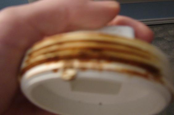

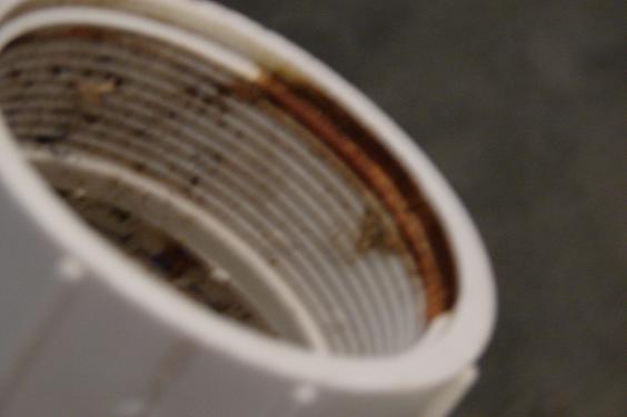

I was doing some "quiet shooting" with some hairspray and after a particilarly loud blast, I had trouble getting my end cap off. After prying it off with a big wrench, I noticed a section that was browned and smoking a little. Is there something wrong?
That sucker is burnt! This happens when a cannon is ignited with the cap off and continues to burn, it has been used a whole lot, or the cap/cleanout adaptor cooled much too quickly when molded which made the whole part(s) shrink. I would suggest tossing it away because you will probably end up blowing the cap(s) out. Typically the female threads are rendered useless by this point, the only option I know of is to cut the chamber where the cleanout adapter is and cement a new one on. This will shorten your chamber but save some pvc, especially if your barrel is not interchangable

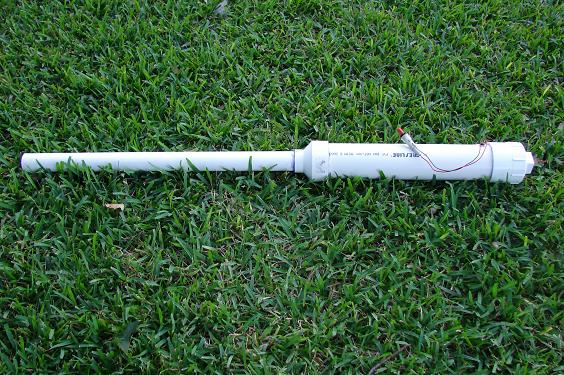

Yeah I think I may have had it cross-threaded when I put it on or something. Putting a new adapter on will be a little tricky though. My sparker hole is very close to where my existing adapter is, so I would have to cut that off and drill a new one...

EDIT: This picture shows how close my sparker is to my adapter.

Not much you could do without redrilling the holes. I say just try and clean out the threads with a triangular file or a razor blade. OR don't use hairspray. Or were you using hairspray because you wanted it to be more quiet?

Coat the threads on that cap with some teflon tape.
Heated air leaking through those threads at around 2,200 K, (just using propane as a model, hairspray probably burns colder), is bound to turn the female adapter brown, as well as burn the crap out of your hand if the leak gets bad enough.

I'm no expert, but i was thinking that you got some hairspray on the threads themselfs, and with a loose fit it cought fire and melted the parts together. If it was mine i would cut as little off as possible and glue another one on, remount your sparker and your done. Happy shooting!
