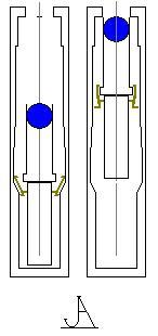

- the extractors
- extractors.JPG (8.38 KiB) Viewed 13135 times

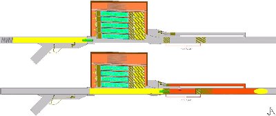

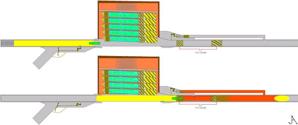

Well, here’s the diagram for my automatic cannon. It’s vary crude, partially so nobody can copy it and get hurt and partially because I suck at MsPaint, but I hope it’s not too crude for y’all to understand it. Whatdoyathink?
Sounds great and only $3 a shell but make it simpler like just have a hopper thing and a pipe with electrodes that when the cartridge drops in it connects and you press the ignition. On the cartridges the parts on the outside that connect to the ignition in the gun should be rings so it will always connect.
- judgment_arms
- Posts: 1272
Well Bluetooth, the reason I used I spring loaded magazine is so there is no miss feeding, and the electricity is continuously applied to the to ring in the bolt (the yellow green boxes in the barrel with the lines through it) when the trigger is pulled the bolt closes pushing a round in to the chamber were the two sets of rings line up completing the circuit from the tazer to the spark gaps fire the whole thing. It’s all explained in my first post.
