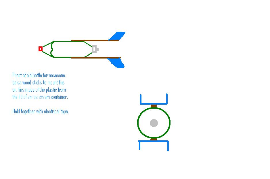

I make my rockets with a balsa wood stick down each side, long enough to reach past the nozzle. I attach the fins to the end of these sticks (these rockets are unstable if you don't make the sticks long enough, because the water is sitting in the back of the rocket, when in a normal rocket the front would be heavier)

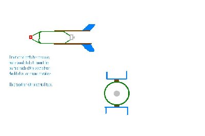

EDIT: This is the type of rocket I build.
