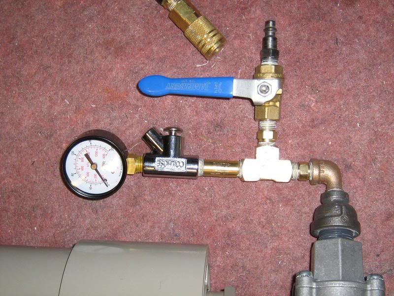

This is my new cannon, you should use a filling station like mine....
quick connect - ball valve - brass nipple - chamber
heres the topic: http://www.spudfiles.com/forums/viewtop ... 422�
