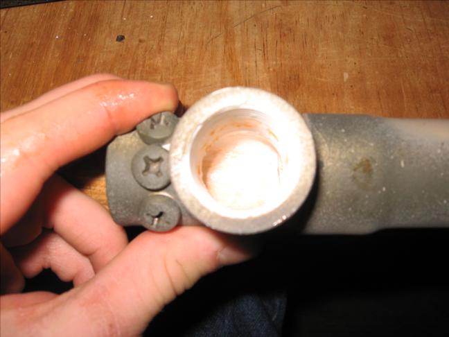

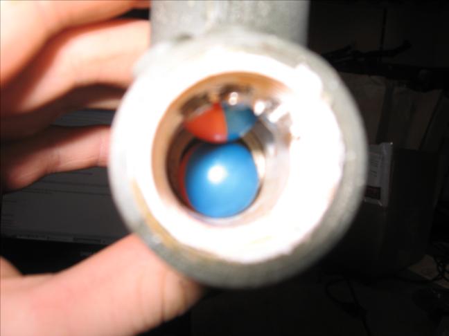

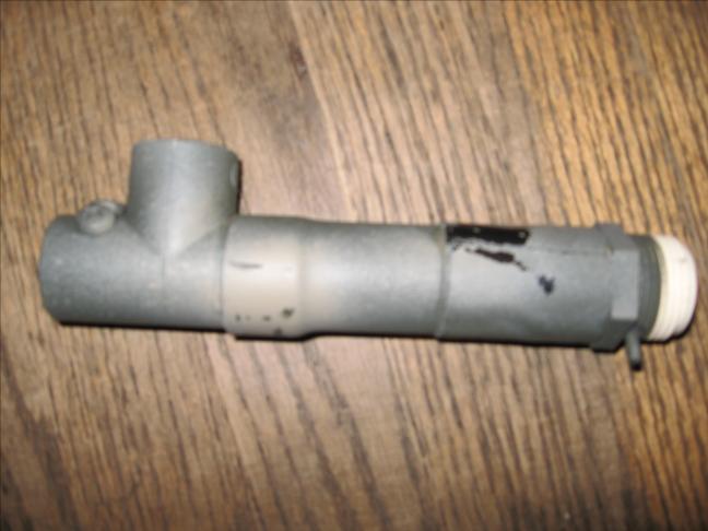

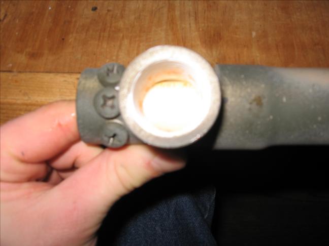

I made a blow forward bolt for my gun. The only problem is it's a little to big for the paintballs. As the bolt comes forward it slices off the bottom of the next paintball. The bolt is similar to the one clide made (go here: http://www.spudfiles.com/forums/viewtopic.php?t=160&)
Here is the gun I'm putting it on: http://www.spudfiles.com/forums/viewtopic.php?t=6109&
Sorry about the crappy pictures.
I'm also not sure how to hold the paintballs in place so two done slide down into the barrel. Maybe I could cut out a hole and put it some kind of leaf spring.

- bolt 001.jpg (34.54 KiB) Viewed 6379 times
- too big
- bolt 002.jpg (21.89 KiB) Viewed 6379 times
- bolt is closed
- bolt 003.jpg (24.72 KiB) Viewed 6379 times
- bolt is open
- bolt 004.jpg (31.5 KiB) Viewed 6379 times
Cool! Do you have any ammo that is a good fit???
If you have a lathe, turn down the front of the bolt and make the part where the paintballs fall into a better fit. The bolt will slide easier, and won't slice off paintballs. I'd also recommend chamfering the bolt, you'll get less chops.

Put a "scoop" type finger on the bolt to pick up the next paint ball??? Something like a piece of flat spring steel with a bend in it to scoop the next ball.
I also see where the barrel could cause you some problems with the sharp inside edge.

The air pushes the bolt forward until the end clears the first o-ring type thing. Then the air floods into the piston through the holes all the way around the piston. Did you look at the animation on the semi auto link. It helps a lot.

You need crown the breach, run your pocket knife around the inside edge at an angle to round it, then take some fine grit, about 150grit, sand paper and run over that to remove any burs left by the knife. The muzzle should also be crowned, it improves accuracy slightly.jrrdw wrote:...I also see where the barrel could cause you some problems with the sharp inside edge.

Hey just so happens I’m making a blow forward bolt, with similar proportion, Its really super ghetto though and has a less effective pop off design, meant to delay the passage of air.
The point is that mine is getto, and back to the subject to fix you problem a further step in addition to tampering bolt tip, is softening the impact , may be by adding a thin layer foam at an angle. But I’d just use marbles

hmm i'll try all that stuff.
It was cheap, I got everything in the picture for like $5. I didn't use a lathe. I found a piece of 1" thin wall pvc thats slightly bigger at one end (what do you call it) this fit perfectly over the threaded t joint. Next I got some 1" cpvc which fit sorta well inside the 1" thinwall. I had to wrap it with a layer of duct tape. 3/4" cpvc fits inside 1" cpvc so that acts as the bolt. The 1" cpvc sort of acts as an o-ring. then I just cut some screws apart (you can see the end of a screw sticking out on the right side in the first picture). I attached the spring to this and then to the bolt in the same way.

judgement arms: I don't really get your last question. It's open to let the paintball in then when you fire, it closes which blocks off the hopper and lets the air through the bolt. Is that what you were getting at?
