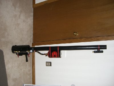

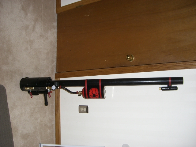

This is my newest propane injection cannon.
It has a 4 inch double walled sch 40 chamber and a 2 inch barrel sleeved to 1.7 inches for golf balls.
The C:B ratio is 1.08 to 1. It has a custom laser sight mount and the chamber fan is an Ozark Trails personal fan that has been stripped and remounted into 3/4 inch PVC, with an external switch and battery pack.
It will easily put a GB through 3/4" solid wood, and when fired, I have yet to actually be able to see the ball leaving the barrel. When fired into an old car hood it will leave a dent that is 3/4" deep and the diameter of the GB. It's almost kind of scary :D
Full Gun
Full Gun

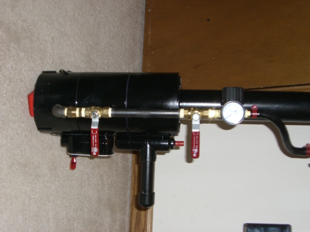

Close up of chamber.

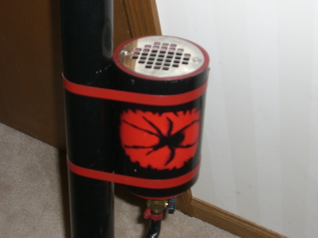

Close up of the fuel tank.

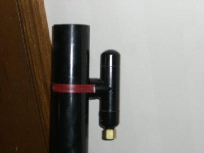

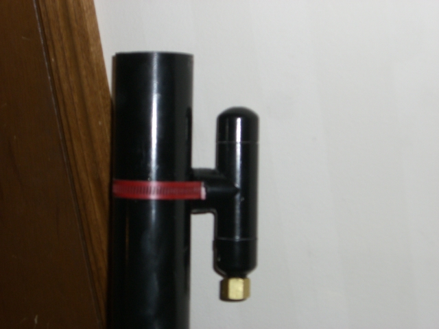

Laser Sight
Laser Sight

It is 2 5 ft lengths of sch 40. A 7/8 inch slot is cut out of one piece, then I squeezed it down with a hose clamp, got it started into the outer barrel, and spent about an hour pounding it in. Not fun, but a perfect fit. And thanks for the positive input!

Nice gun. Did you spray paint the black widow or is a sticker? Why is your laser sight so big?

Wow...I don't know what to say to that other than thanks for the compliments on the paint. It is not a sticker. I painted the main body of the tank case red, then made a stencil of the spider and then sprayed the black over the top of the red.
Also, the laser sight is actually a 500 yard range laser pointer made for construction engineers. I cased it in a 3/8 nipple, then sleeved that into a 3/4 pvc t with end caps. The threaded brass cap is used to turn it on. It had a small button on the side of the pen that I glued down. I then soldered the battery cap on the rear of the pen into the brass cap so when I tighten the brass cap down on the nipple, it pushes into the back of the batteries and turns it on. Sounds complicated but it really wasn't hard to do.
