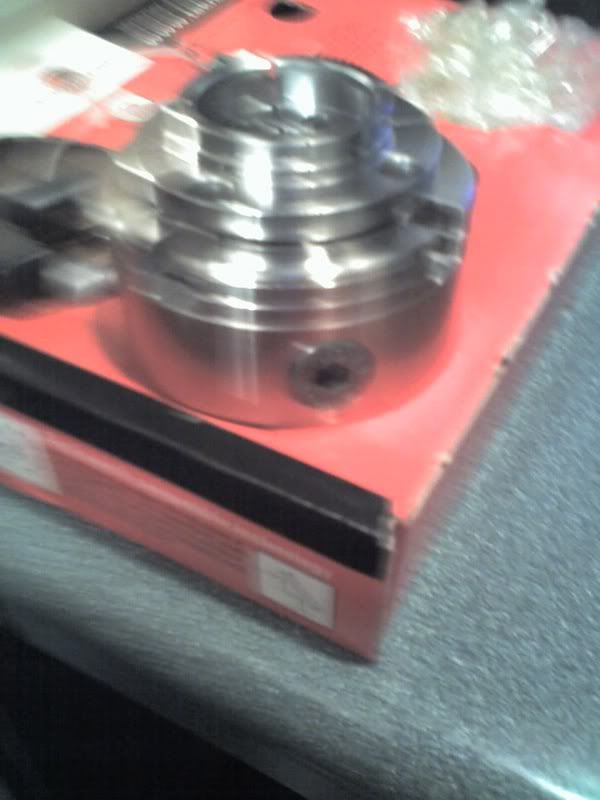

This tiny piece of equipment cost over $300!<br>

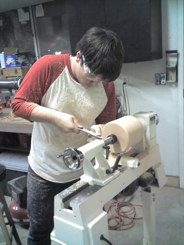

Heres me using my new lathe to cut the wood into the basic shape of my bowl.

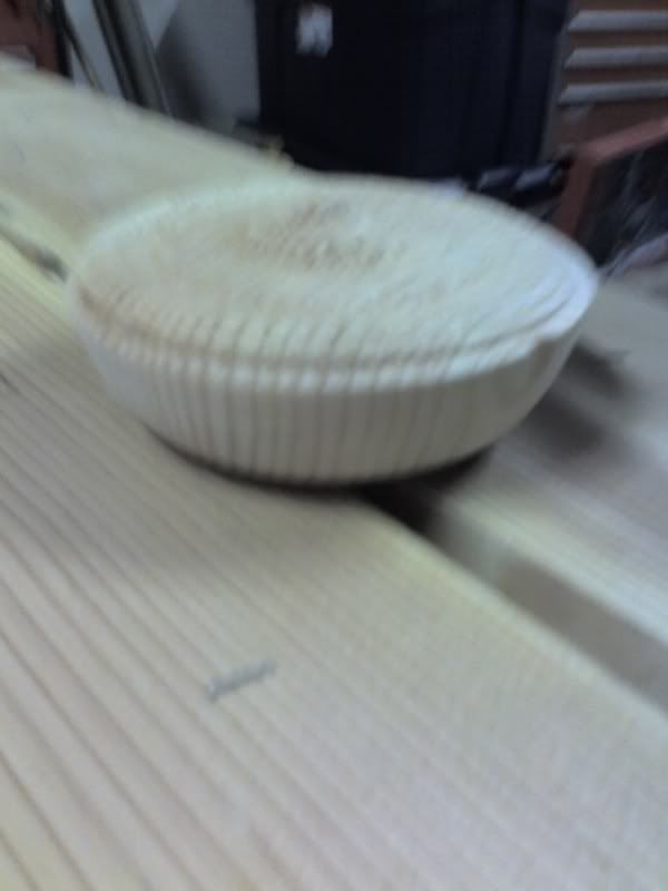

Heres the bowl itself, I haven't finished it yet and still needs to be hollowed out. <br><a href="http://photobucket.com" target="_blank"><img src="http://i30.photobucket.com/albums/c325/ ... 7_2123.jpg" border="0" alt="Photo Sharing and Video Hosting at Photobucket"></a><br>

edit:just the wood chuck cost 300. It cost more than the damn lathe!
edit(again): the bowl is currently unfinished I still have to hollow it out.

I can see the back of your hybird behind you on the bench, just over your left shoulder. Yes Jet lathe's are nice, and i think you could have found that chuck on Ebay for way less even though new is nicer. I've been searching for the rite deal on a good metal lathe myself, for my useage i will need a much bigger one, no less then 10" over the bed swing. Looks like your lathe has about 5" over the bed swing. The bowl looks nice so far, wood is a bit tougher to make look good, odd grain/knots/tool controll. I feel your pain on the burn thing. When i was 13 i poped the top off a radiator and got 2nd and 3rd degree burns all over my right side and back, the good news is the cap missed me! Maby you can get some Aluminum round stock and build piston's, not the entire valve like everybody else is trying to do, just build the piston's, let any "customer" build the rest on thier own. Just a idea.

Your lathe is strictly for wood. Personally I wouldn't even attempt to turn any metal on it just because it would be difficult to get any sort of precision without a tool carriage to hold the cutter. Cutting wood and plastic is no problem though. The thing with cutting metal, even aluminum is that you need a lot of holding force to keep the cutter from going where it wants to. If you wanted to try turning metal you could either find or make your own tools, with longer handles (make them like three feet long if you want) that way you can apply more control at the cutting end. Also, you don't need carbide to cut metal. High speed steel tooling works just as well. Carbide is used for high production rates and to take huge cuts on more powerful machines. If you cut steel with a high speed tool make sure that the chips coming off aren't turning color from the heat as this would indicate that you are "burning" your cutter.
