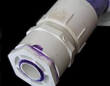

<img src="http://img.photobucket.com/albums/v611/ ... change.jpg">
Here we have a look at the muzzle of a 1" barrel insert for use in my 2" barreled pneumatic, when it is in the pneumatic.
Note the bushing, the male NPT adapter, and the female NPT adapter on the normal barrel of the launcher.
