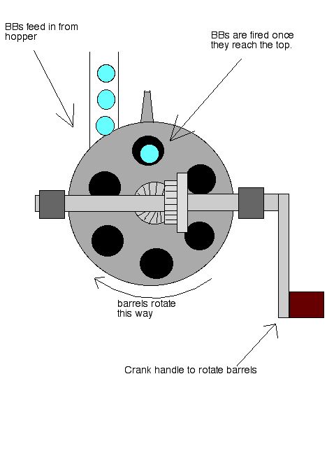

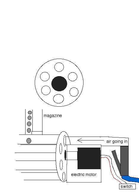

I had this idea of having a constant air flow to power an airsoft gatling gun.
I am not actually going to build this, but I hope someone will take my design further.
Airsoft Gatling
- origin unknown
- Corporal
- Posts: 533
- here is a diagram
- gatling.JPG (27.02 KiB) Viewed 11438 times
- better diagram
- gatlinggun.JPG (29.34 KiB) Viewed 11376 times
Last edited by origin unknown on Sun Apr 22, 2007 6:03 pm, edited 1 time in total.

I'm a little confused why you would even need it to roatate.
so is it like while it passing between holes another bb falls?

no you would have to have the barrels rotate according to the speed that the BBs are coming out. if you can do that you would have a great gatling gun.

you would need to mount the mag on the side insted of the barrel that is fireing. this is because after one shot all the bb's will have been shot. this is way to complicated and i think it is a bad idea. i have experimented with this idea before.

you would need some sort of cam mechanism that would only load a bb in when the barrel is lined up with the clip. otherwise its would jam or dry fire or something. also i think a gravity feed mag would not work. the constant rotating of the barrels would not allow enought time for the bbs to load unless you plan on it being semi auto

Look at this, it is a diagram (i updated the top diagram) I made of the guns feeding method. This is exactly how R.J. Gatling's patented feeding mechanism worked on the original hand cranked gatling guns. Go to this link to find out more. http://science.howstuffworks.com/machine-gun2.htmdippydodo03 wrote:you would need to mount the mag on the side insted of the barrel that is fireing. this is because after one shot all the bb's will have been shot. this is way to complicated and i think it is a bad idea. i have experimented with this idea before.
Trust me, it works.

Yes, it's doable. you can make the body and the whole thing out of pvc which i had figured out how to do with a little T fitting modification. the design would leak air, but it would work as like as a demonstration to show how a gatling gun works. I am not building one though. It would take a little too much time on my part. Maybe I'll make one out of pen tubes, in fact i will do that right now. >gets up and goes into bedroom, thinking<
