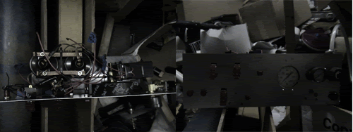

The fuel/air metering system. Consists of 3 valves, two of which are
three-way valves (for the fuel meter and compressed air) and the one-way valve is for venting.
The control panel (back and front). Propane regulator and air compresser gauge are mounted on the panel. The three top switches are (in order from left to right): vent, fuel, and compressed air. All valves work off of 24 volts.
The toggle switch on the bottom is for arming and charging the capacitor, and the pushbutton is for firing the cannon (discharging capacitor into igniton coils)
The control panel consists of a 3/16" thick steel plate, and has the labels for each switch stamped into the metal (sorry, the labels didn't get picked up by the camera).
