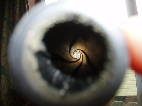

The Rifled Barrel!!!!Which makes this a Real Rifle!
The Rifled barrel!
The Rifled barrel!

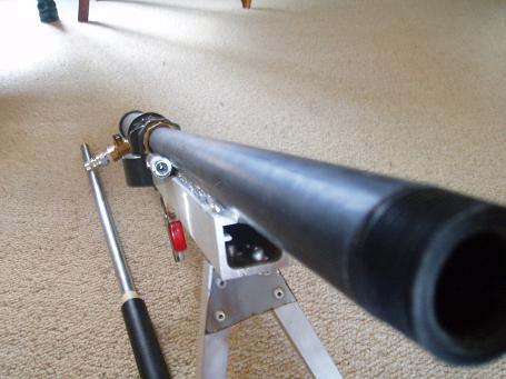

The gun on its side with the Ram rod.
Looking down the barrel.From an angle of course ;)

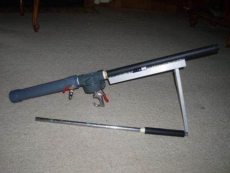

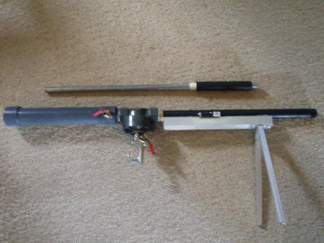

The whole unit.
The whole unit.

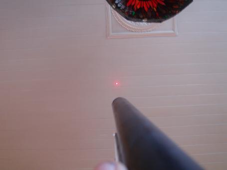

The laser and barrel.Can you see the red dot?

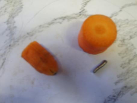

A finished slug and one of the way.Notice the little bit of lead for the tip.

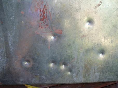

My back stop dented from marbles.

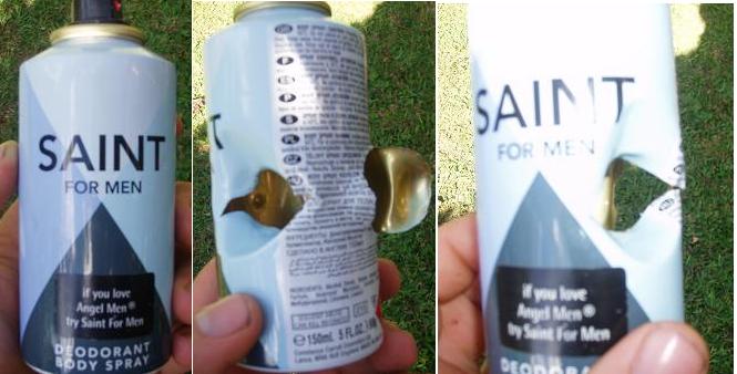

It's Changing!Nice hole.

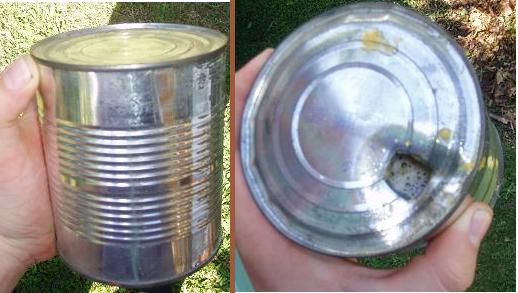

Before and after...A 3 year out of date can,which coverd me in mush when I shot it.
