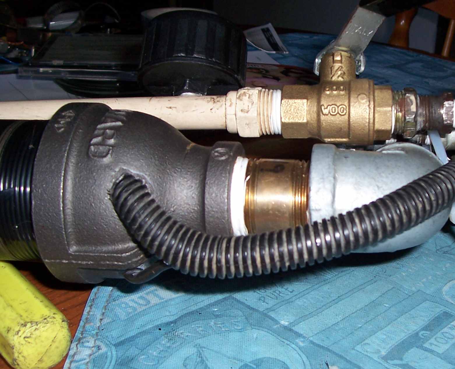

This is a no-burstdisk hybrid which uses a piston and spring to retain pressure. Although it is in an experimental stage, it is still fully functional. Today I did dryfires at 1.5x and 2x mix to make sure everything was working properly.
I am currently making a new piston (the first one was quick and cheap and eventually blew an o-ring) and hope to get it working at 4x over the next few days.
Materials/construction
The chamber is made from 2" sch40 iron (I'm looking to upgrade this). The fittings are steel, iron and brass. It ended up being fairly heavy for its size (probably about 12-15lbs)
The piston is housed inside the brass pipe below the tee and is forced upwards untill it vents out the barrel (it shouldn't be that hard to visualize).

Almost everything is detachable, including the barrel, chamber, meter, and spring cap. The cap can be removed and the spring tension ajusted to allow for higher chamber pressures before it vents.

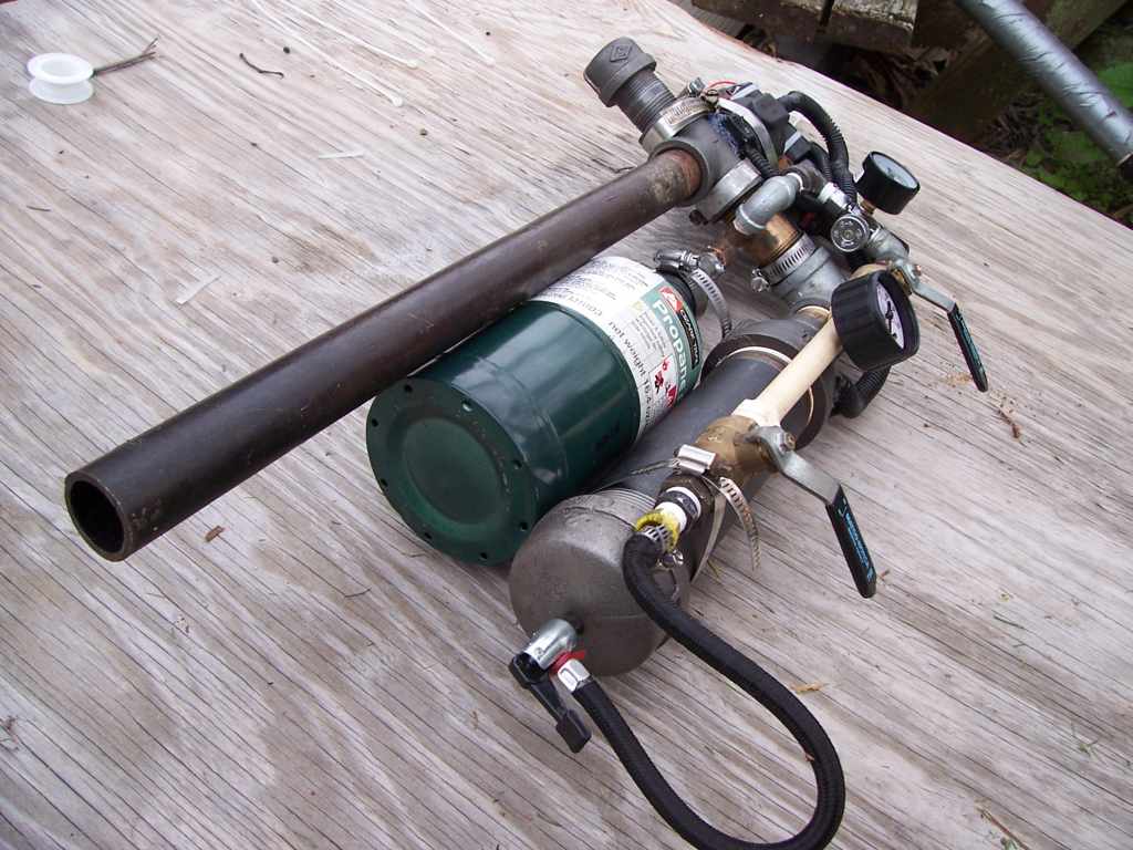

Full view. I forgot to put a ruler by it for comparison, but the tank should give you the general idea.

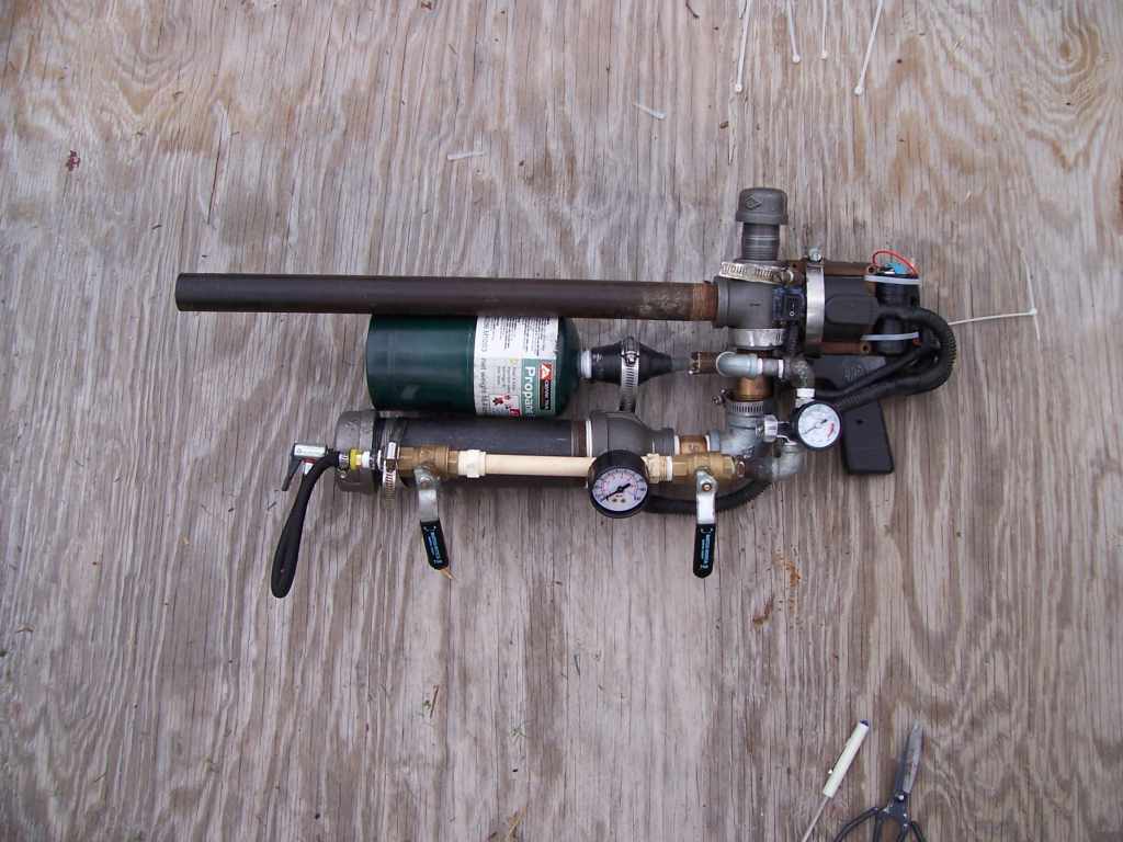

ortho view.
ortho view.

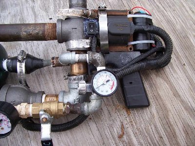

close up of the handle, firing circuit, reg and tee.

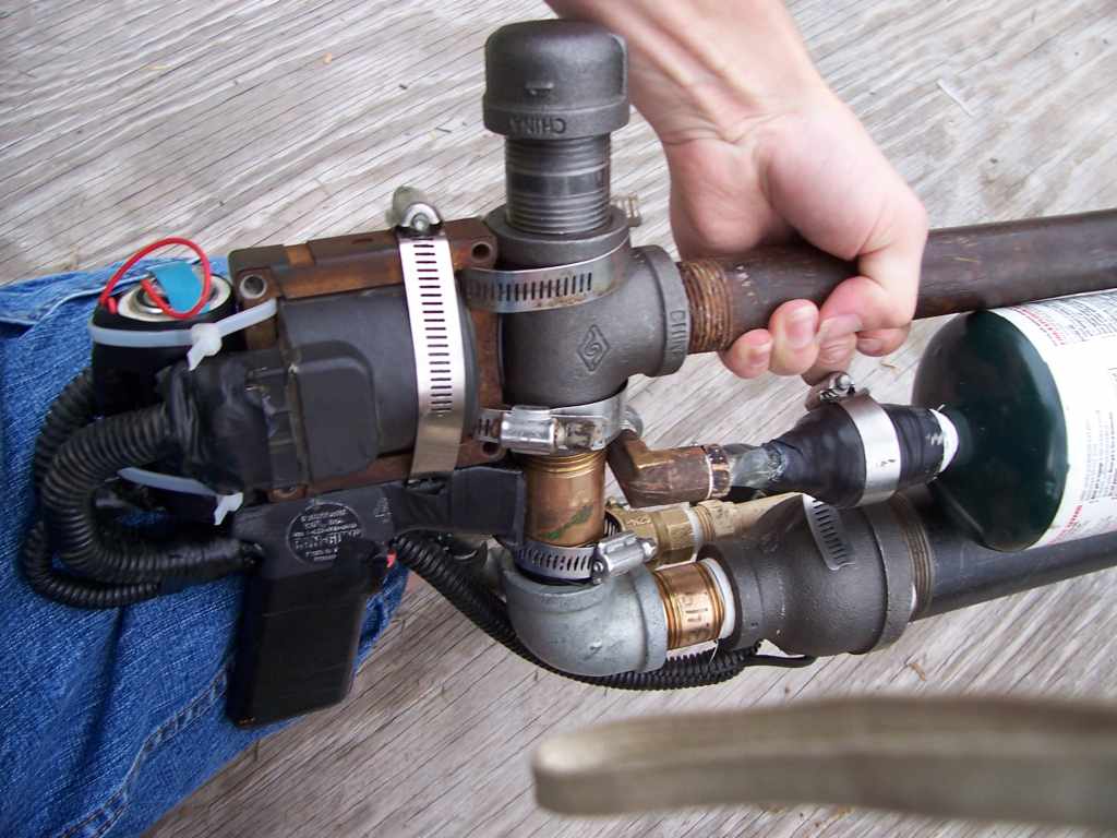

close up of the middle.

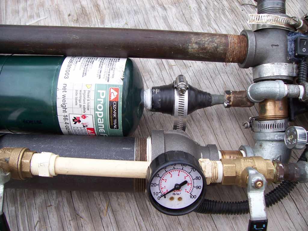

The other side. Not much to see here. Just hose clamps.

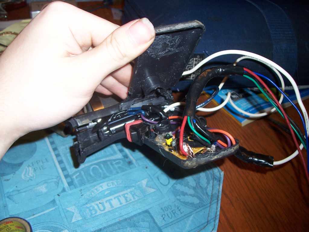

The spaghetti monster that lurks within the handle. <br />If you look closely you can see jesus.

No way, that's sick. Is the piston in the top part of the Tee that holds the barrel?

Ill post the piston diagram tomorrow, along with my concept drawing.
