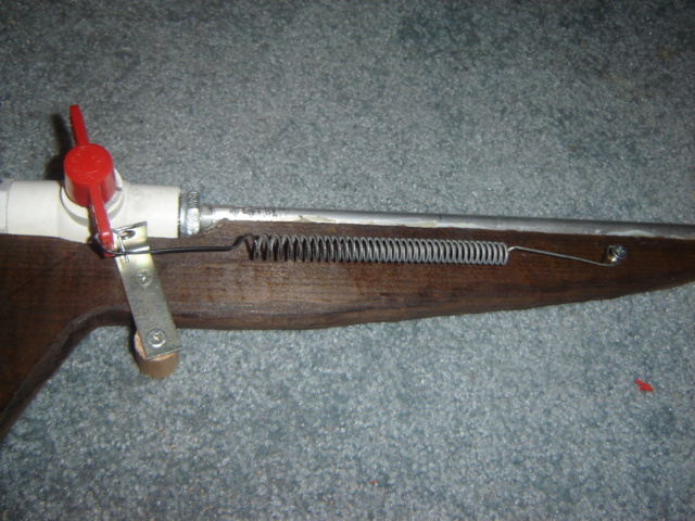

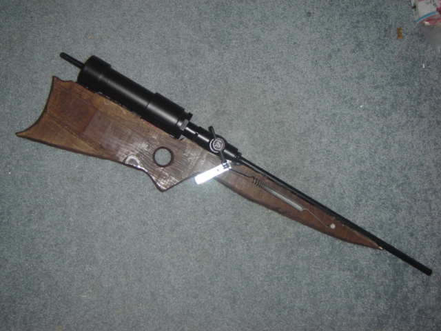

This here is my blow dart air rifle, just recently built. This thing shoots standard .40 cal blow darts from a 1/2" OD alum tube. The gun assembly is made from PVC, with the exception of the alum tube, and the metal reducer used to adapt the alum tube to the PVC ball valve. And that brings me to the triggering setup. Right now I'm experimenting with new ideas for triggering ideas that are cheap yet effective. This idea takes a simple ball valve, combines it with a spring and an angle brace positioned just right to hold the valve closed. When the angle brace "trigger" is pulled, it releases the valve handle, and the spring pulls the thing open fast. The air chamber is made of 1 1/2" pipe, and uses a regular tire valve for filling. I also conjured up a simple one way check valve type of setup to keep air inside the chamber when removing the tire pump's nozzle from the valve, using a flexible plastic disc that seals the tire valve from the rest of the air chamber. Its actually a close cousin to the diaphragm triggering system Ive seen on many spud guns, but it works. The stock is cut from some 1/2" pine board with a thumbhole configuration. The assembly is plastic epoxied to the stock for a secure mounting, with everything stained and spray painted to make it look just as good as it shoots. This thing launches blow darts at super high speed, I shot the thing at my bed from 10 ft away and the kinetic energy from the dart was enough that the wire dart separated from the plastic cone when the dart hit the mattress. So now theres a dart stuck somewheres in the mattress. Oh well, all in the name of progress.
nice job
but i dont like the idea having the chamber near ya head.
neways good work, stock looks good

Does that ball valve system open all the way, or does it only open most of the way?

The ball valve opens most of the way, but with the air pressure in the chamber and the light weight of the blow dart, even most of the way is enough to move enough CFM of air to shoot the dart pretty fast.
