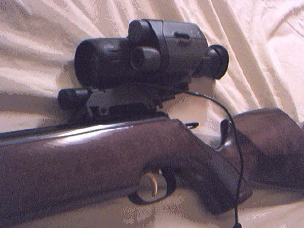

have a look here ;)
I have me one of these mounted on my HW97K:
Weihrauch HW97K NV closeup.jpg (34.71 KiB) Viewed 4818 times

jackssmirkingrevenge wrote:have a look here ;)
that scope looks so nice jack :D
experament-u2 wrote:that scope looks so nice jack :D
It is, shame that zeroing the laser is such a hassle - ah well, good ol' soviet technology :D
